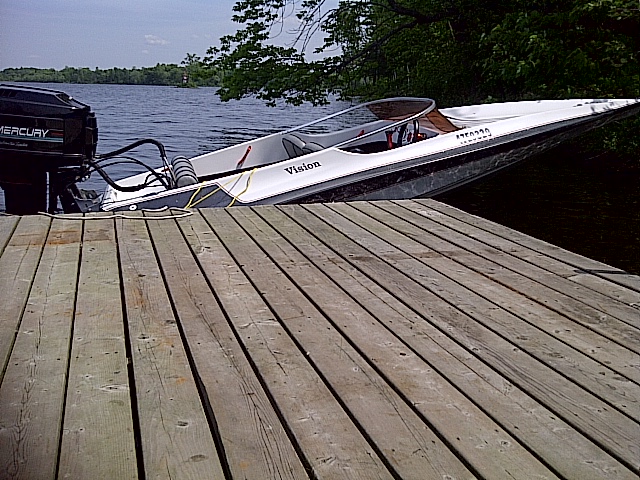

Check out this picture of mine. At this point I still had the 30 pitch prop, had just bolted on the 6" setback, with no counterweight up front. The boat was very twitchy with just me in it. I hit 85mph that weekend, but it was a little scary. You can see how the motor weighs down the rear of the boat, the rear wingtips are actually under water in that picture, and there's about 1" of water inside the splashwell. Coming down off plane was nerve racking. Another learning experience lol
