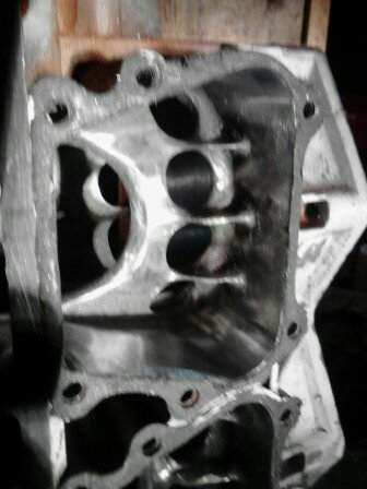

I picked up a 200 for back up and did a few things to it and then modded my 150 to the stock specs of the 200 and then did more. The scallopes are cuts in the block under the intake ports, like half circles, and match that to the pistons. I get a pic up soon of what I'm talking about.

Post: # 19743Post bruzercomp81 »
This is the cylinders but I don't have a pic of the pistons.
