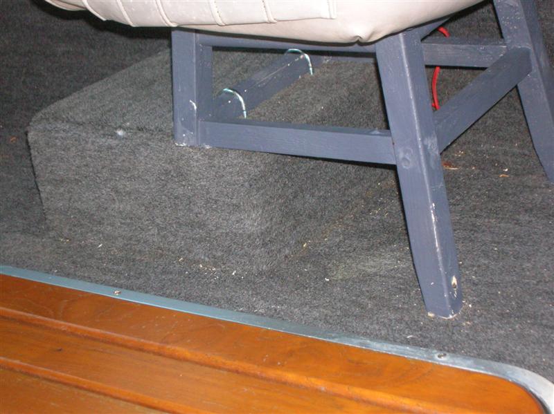

I moved the seat back about 9" and up about 7" for skiing, the primary function of this light and towable boat. I've attached a photo showing imperfect but seviceable work. Ultimately, I may go for a plywood plate epoxied to the deck supporting a lagged in pedastal mount. For now, I used an ordinary foot stool with all junctions reinforced with long deck screws. The front legs are cut off below the front crosspiece which is U-bolted to the Voyager seat pedestal. Rear legs are each toe screwed into the deck. The seat roundtable is, of course, bolted to the top of the stool. The original seating position made about as much sense as a crotch rocket. Port side is, however, suitable for our spotter, "Inflatable Judy."
