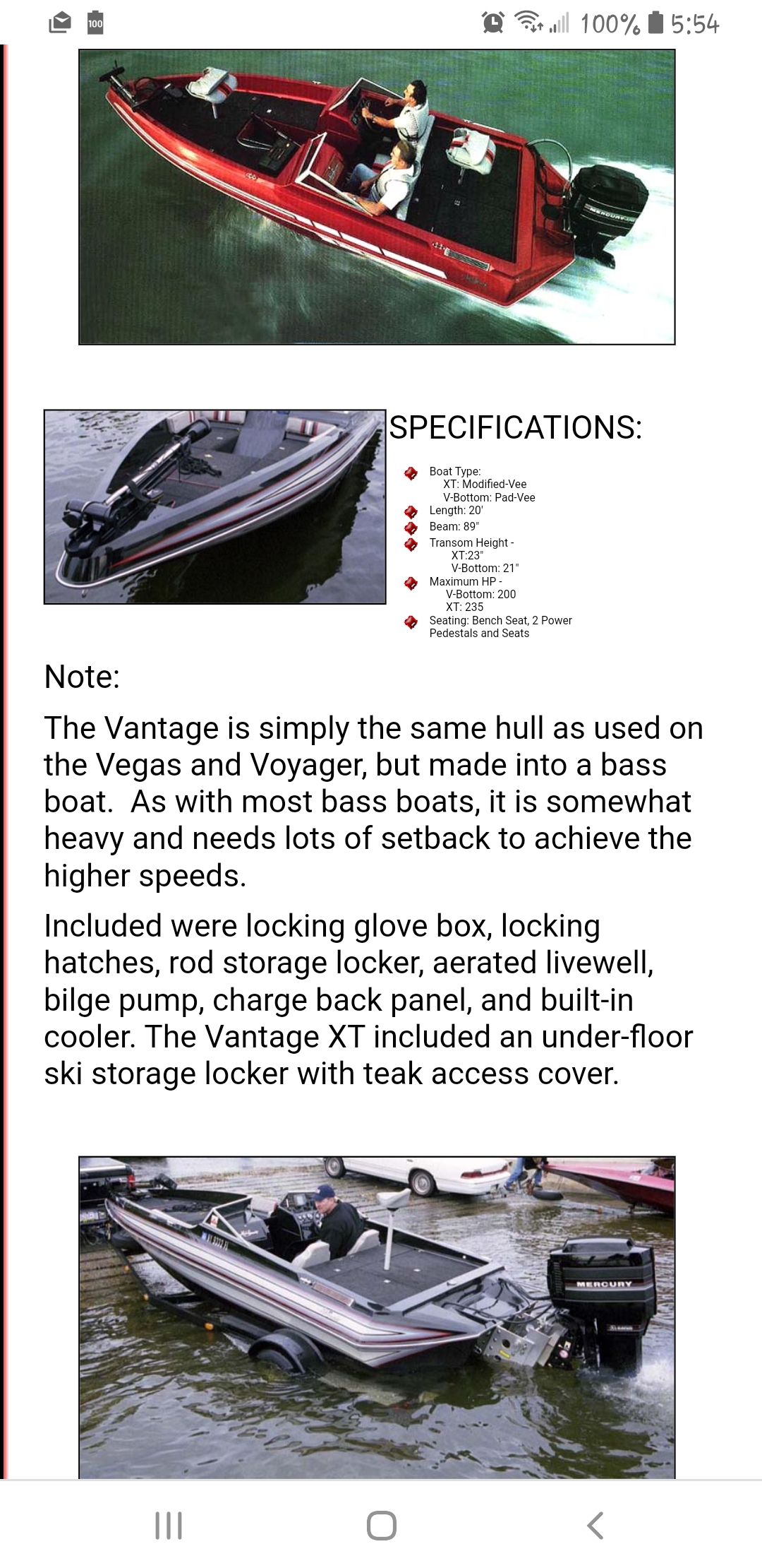

Post: # 24966Post Hippie459MN »
Here you go also...

Thanks a lot. Yeah It used to have a jackplate setup on it but the ram that controlled it was locked up. I ended up taking it off. In the restore I'd probably end up getting some setback in it, maybe not as extreme as that bottom setup but something like that. I just think that I could make this a 70mph boat with the 200hp I have which would make me happy for awhile.
