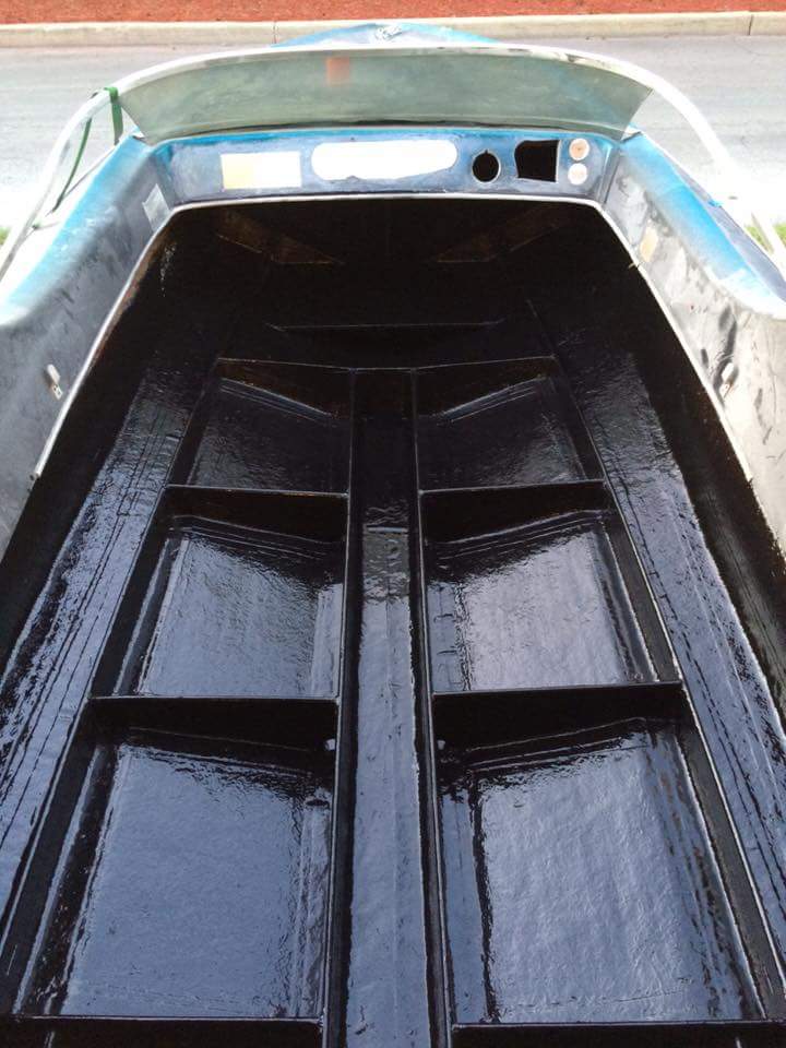

The boat will have zero core. Remove at the core, and then do a thick layup then build kind of a frame for the boat. No more rotten core. Might go composit transom but time will tell.
Here is Dan Bulgers vector he is building. There is no core in the boat.
:up:

It's actually not much heavier if any at all. Scott Steffe (AFR) built Beefkid hydrostream with no core pretty much the same way and that thing was a rocket! I have pictures on my computer unless Scott chimes in here by chance.
