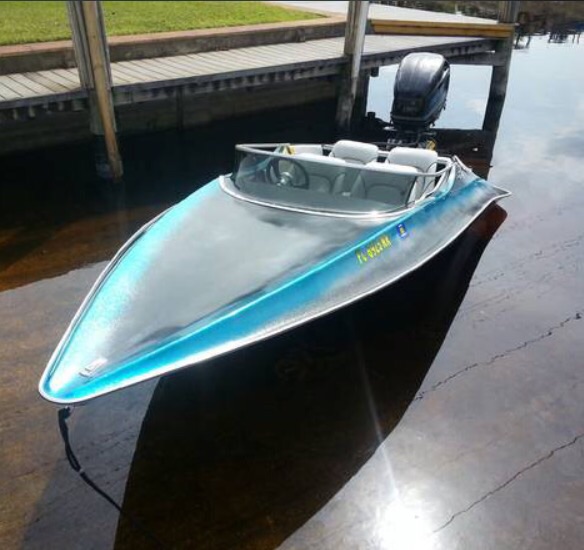

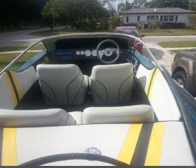

I just bought my first hydrostream. It's a 88 vector. I have to replace the core so I am going to go ahead and do the floor and transom as well. Will need a lot of advice and answers to questions. Everything is appreciated!
