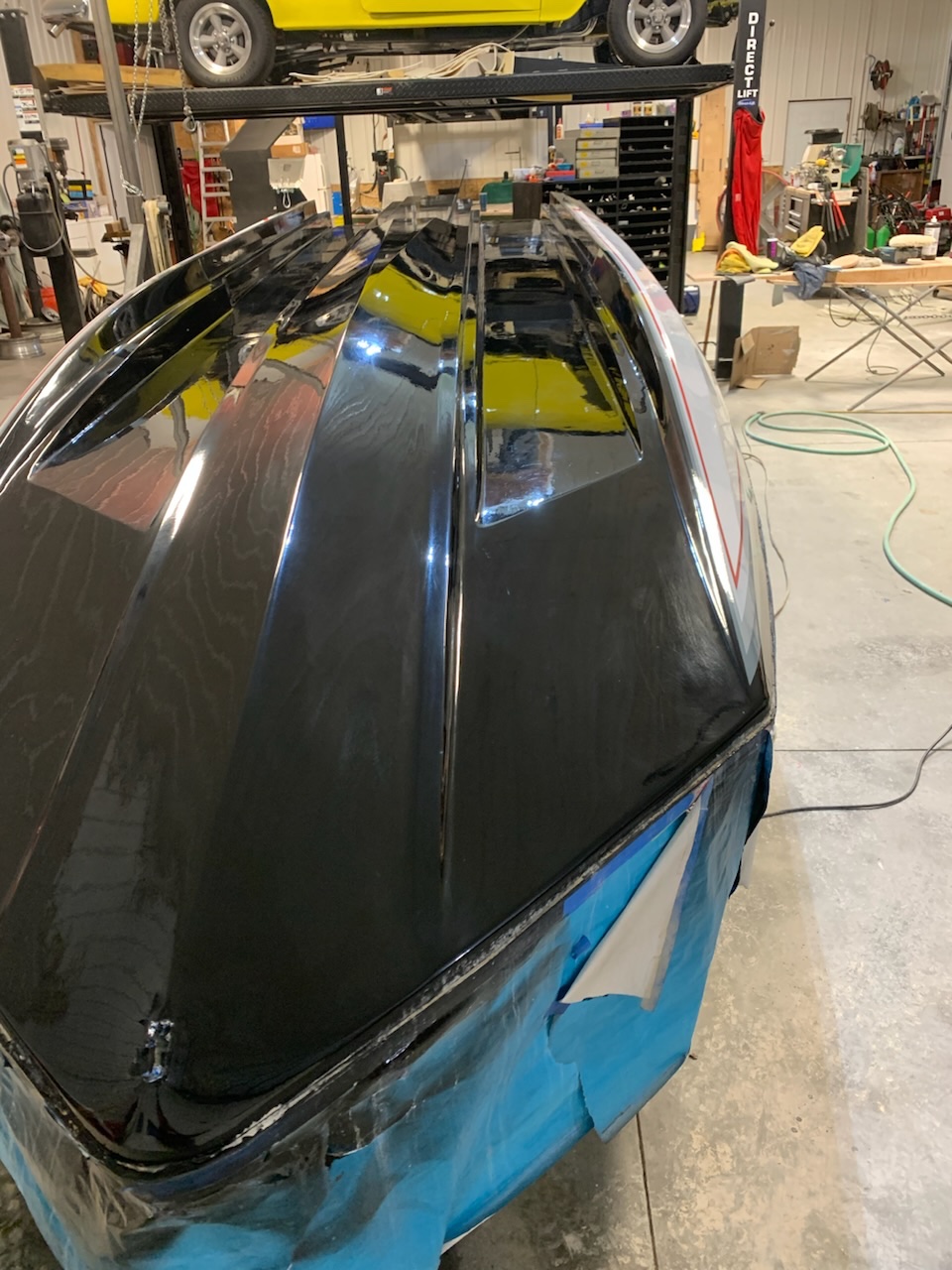

Yesterday I spent 7 hours wet sanding the clear with 600 then 1500. I let that sit “open” overnight to off-gas.
Today I spent 8 hours buffing.
Super duty 3M with a wool pad
Regular 3M compound and wool pad
6” random orbit with “The chemical guys “ # 32& 34 micro finishing compounds.
Tomorrow will be # 36 & 38 optical grade polishing cream.
It’s overkill for the hull but I gotta stay busy while it firms up enough to set back on the trailer.
In the 4th picture down, in the tunnel, you can see my repair is smoother than the factory. Lol….
