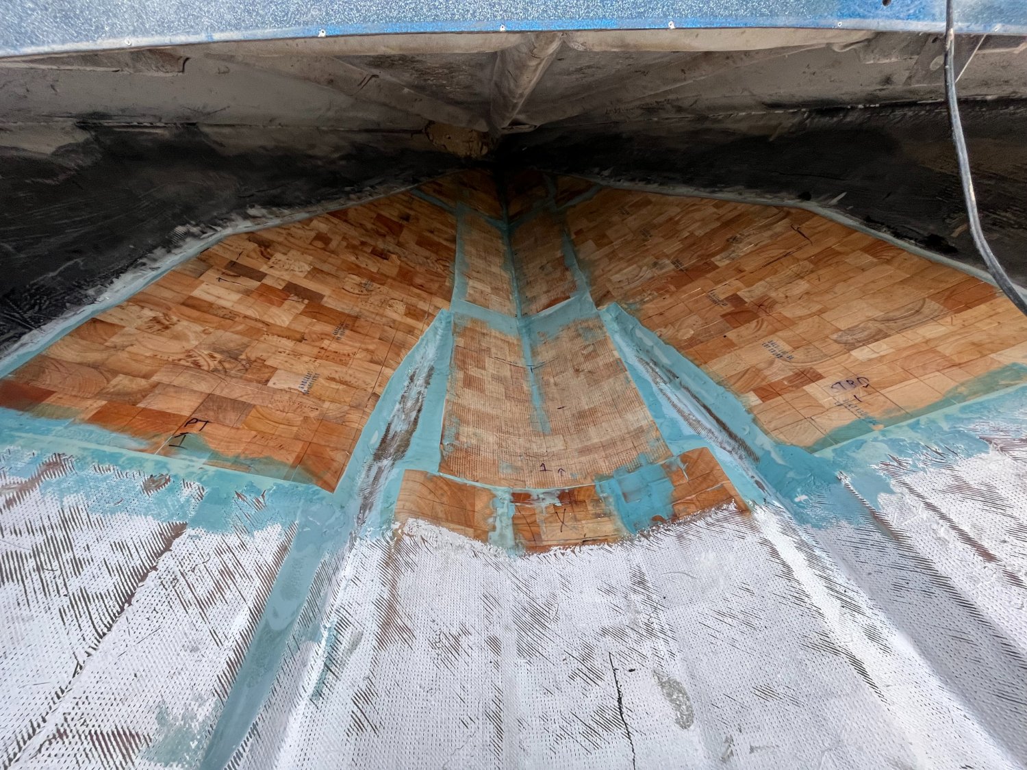

Haven't posted a update in a little while so here you go. Final sheet of bow core is bedded in, cant say its an easy task with the deck on. I also got the stringers cut and started filleting around the final pieces of core.

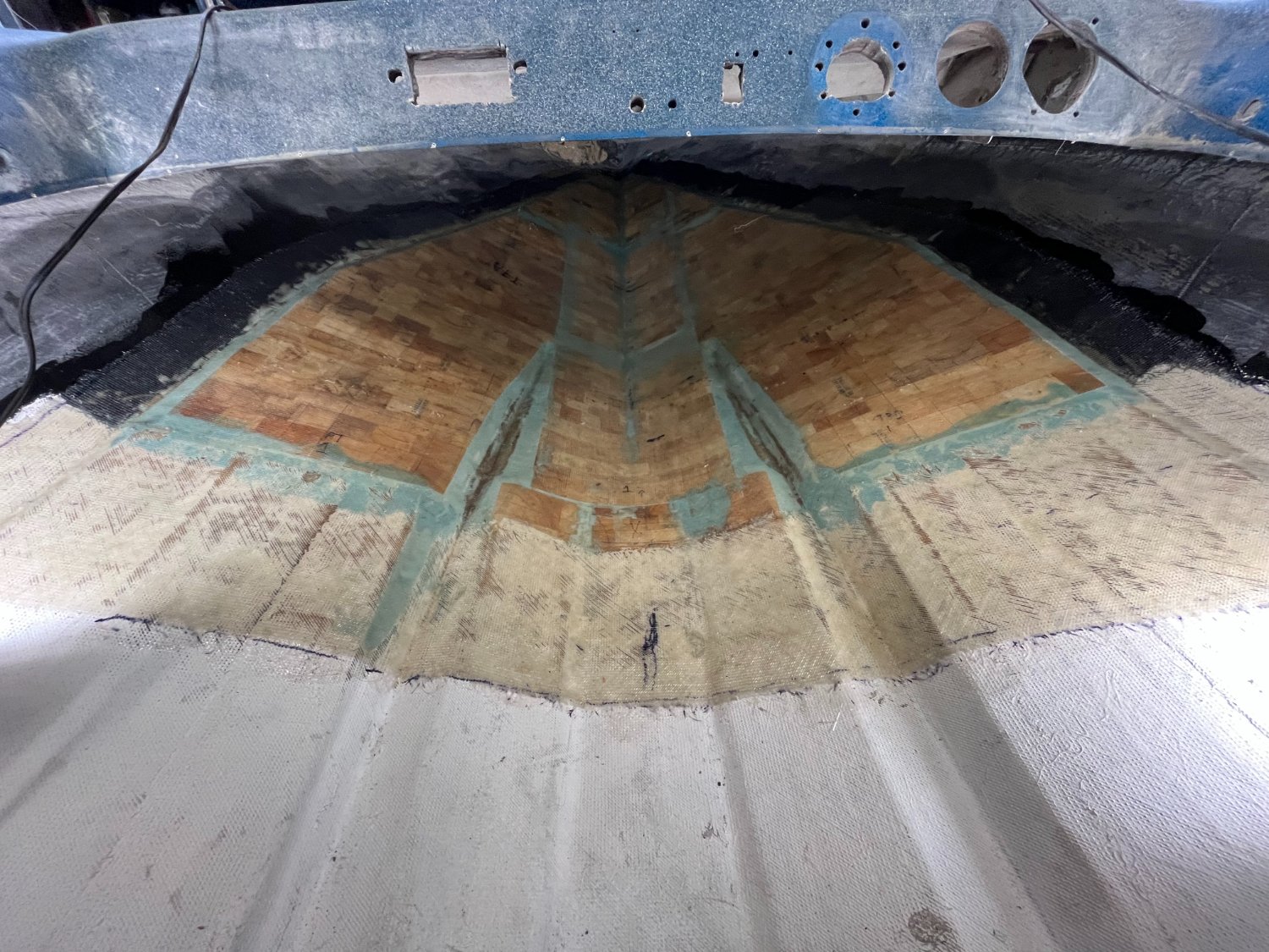

I can finally say the hard parts over. Core is 100% in. Im going to add a layer of .75 csm to really seal it up along with a layer of waxed gel to cure everything off.
