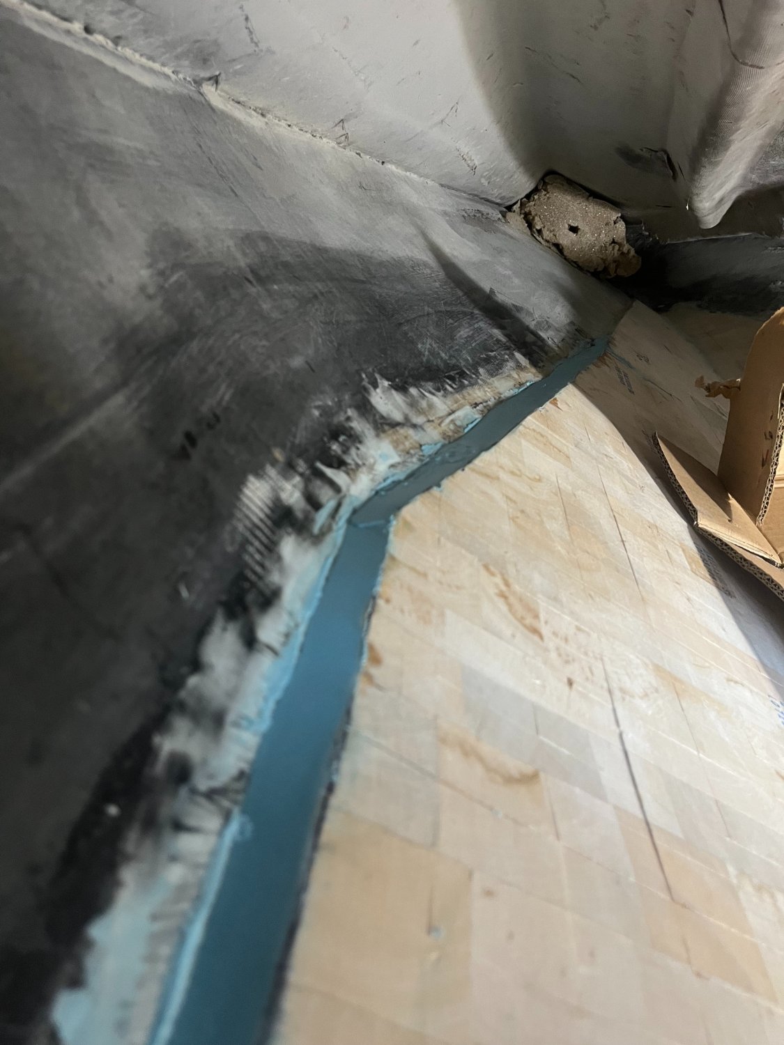

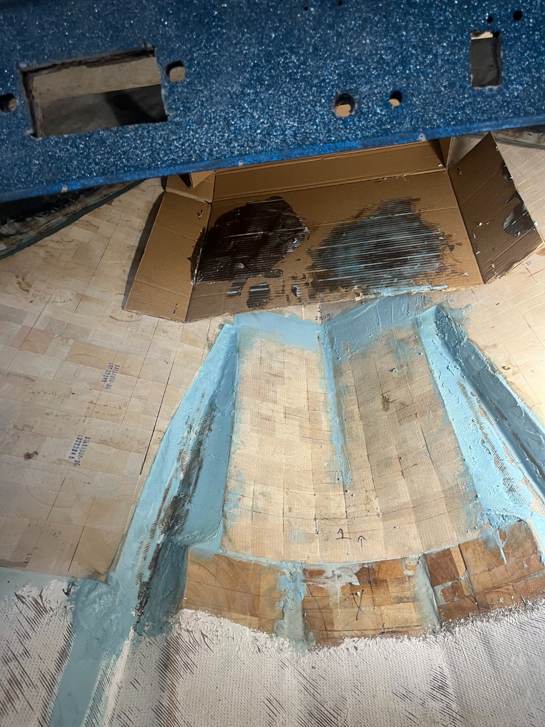

Moved on to everyone's favorite part of the recore, the bow. Got some small patches laid down the middle to thicken up were I had to grind. Haven't been able to work on it a whole lot this week, hopefully by the end of next week I will be wrapping up with the core. Since I didn't get out of work early enough to get the supply's I need for the bow core and stringers I started cutting and dry fitting the floor and splashwell delete

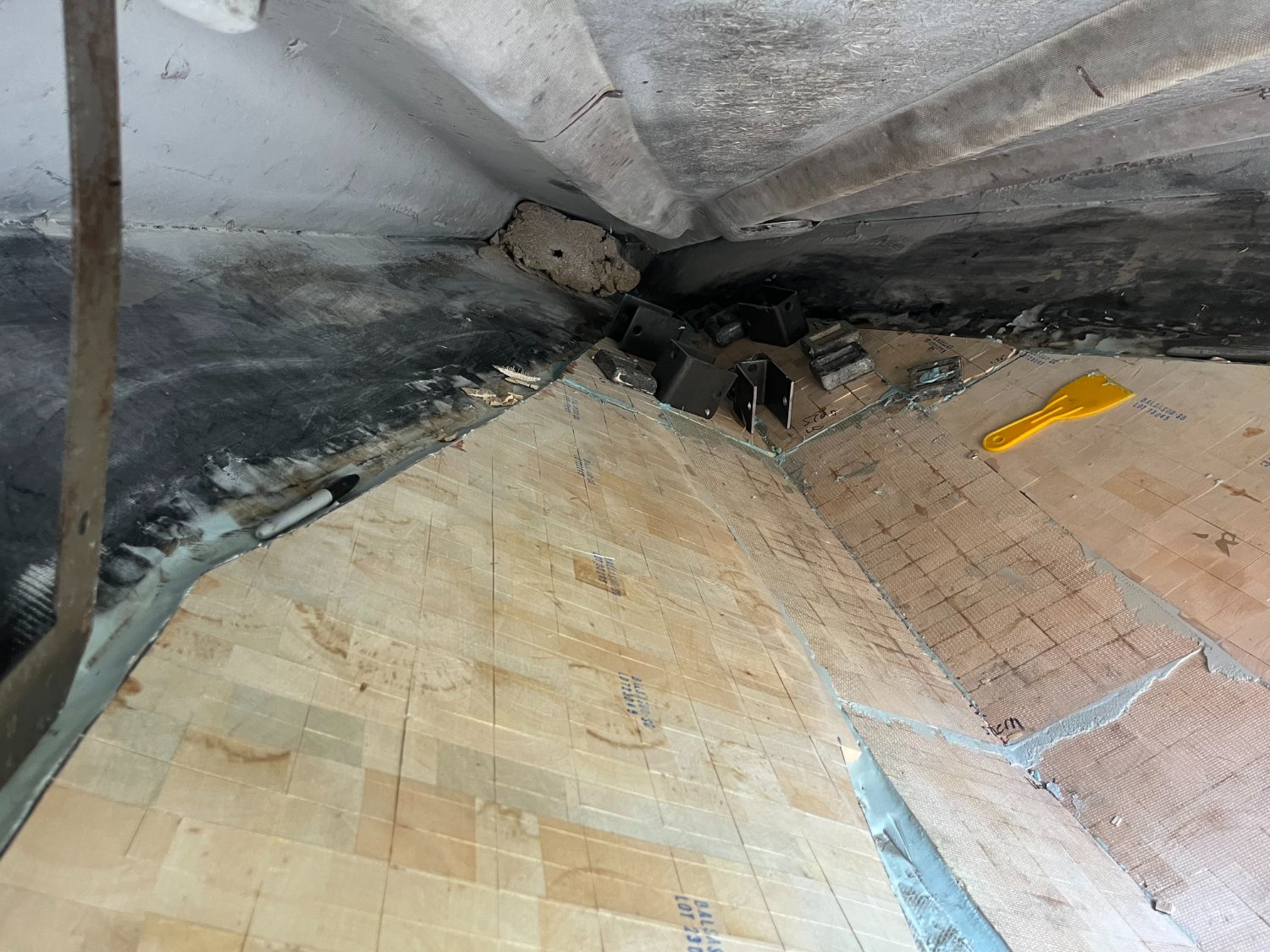

Got some glass laid in the bow and on the honeycomb for the splashwell delete. Does anyone happen to have a link or part number for the black covers I see people put over the factory rub rail? Mine is fairly beat up and I have no interest in spending my life drilling rivets out. Thanks

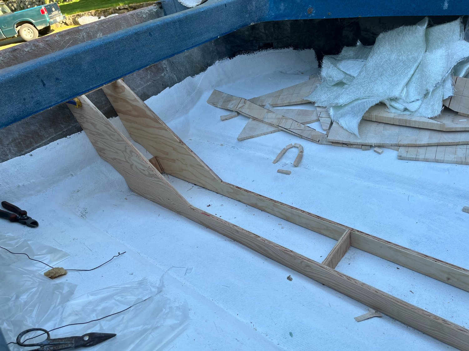

Some bow core cut to shape and bedded in.

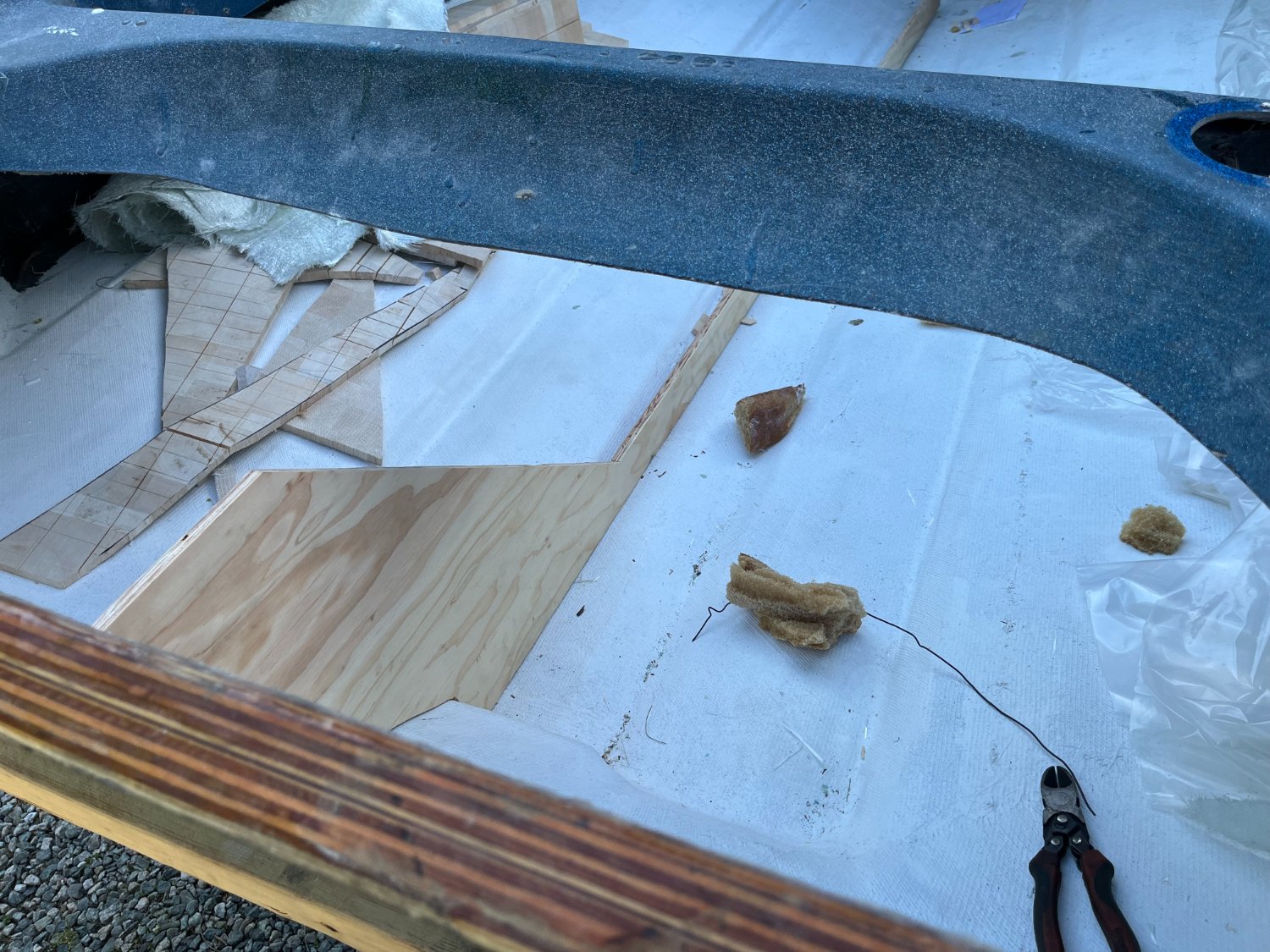

Haven't posted a update in a little while so here you go. Final sheet of bow core is bedded in, cant say its an easy task with the deck on. I also got the stringers cut and started filleting around the final pieces of core.
