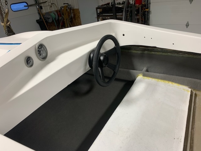

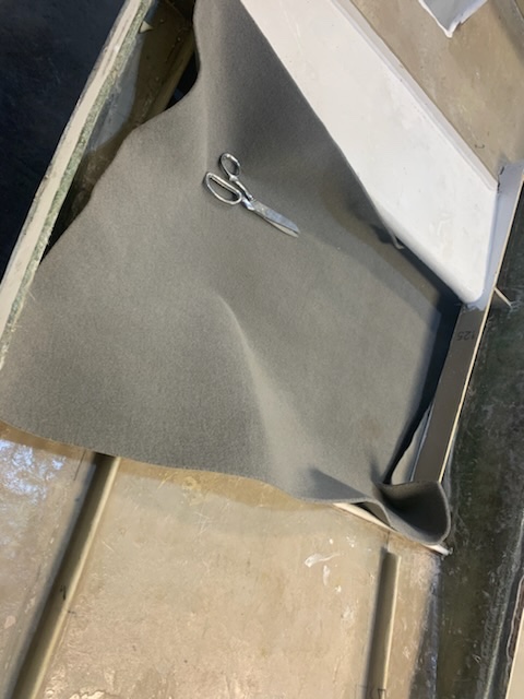

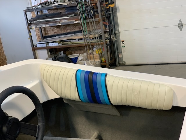

Before the deck got on, I installed the gauges, steering and carpet.

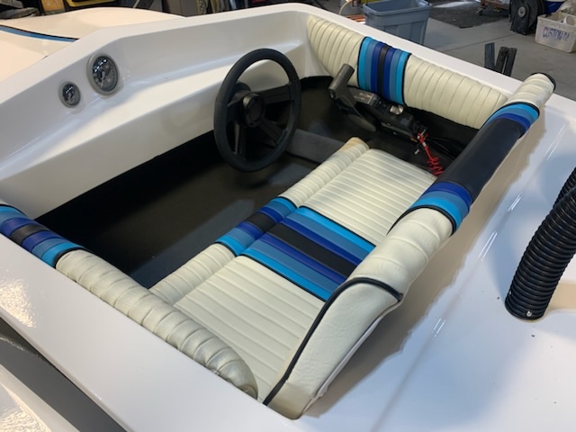

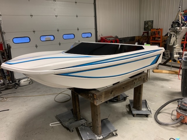

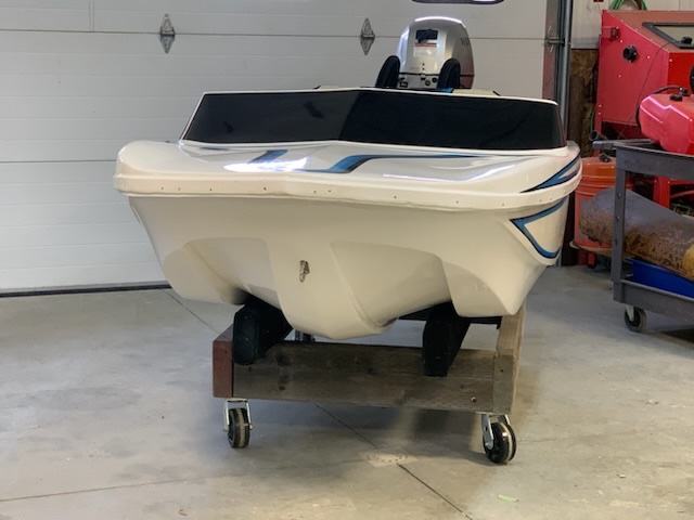

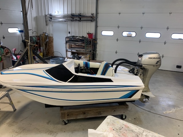

Got the deck on, motor mounted, mini rigging tubes installed, shifter and interior put in.
I had to angle the shifter to get room for your leg to get beside the steering wheel.
I’m glad I dropped the floor!! It’s actually really comfortable.
The motor was a freebie from my brother in law. It’s a 15hp Honda 4-stroke. It has power trim and no tiller arm!
It’s a20” motor and this boat has a 15” transom. I made a mini setback plate with 5” rise out of some 2” aluminum channel.
Almost done. Rub rail and a little wet sand and polish coming…
