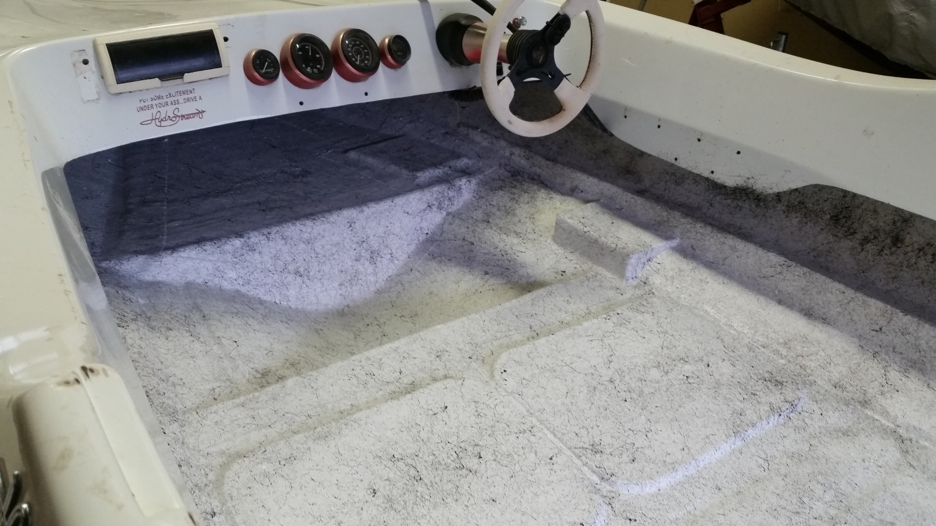

Here is how the floor and airbox were replaced in my Vulture.
Re: Vector build with pics
Of course the floor is wider in a Vulture (and Vking) then a Viper and Vector. The Vector and Viper use the same core and floor layout pretty much.

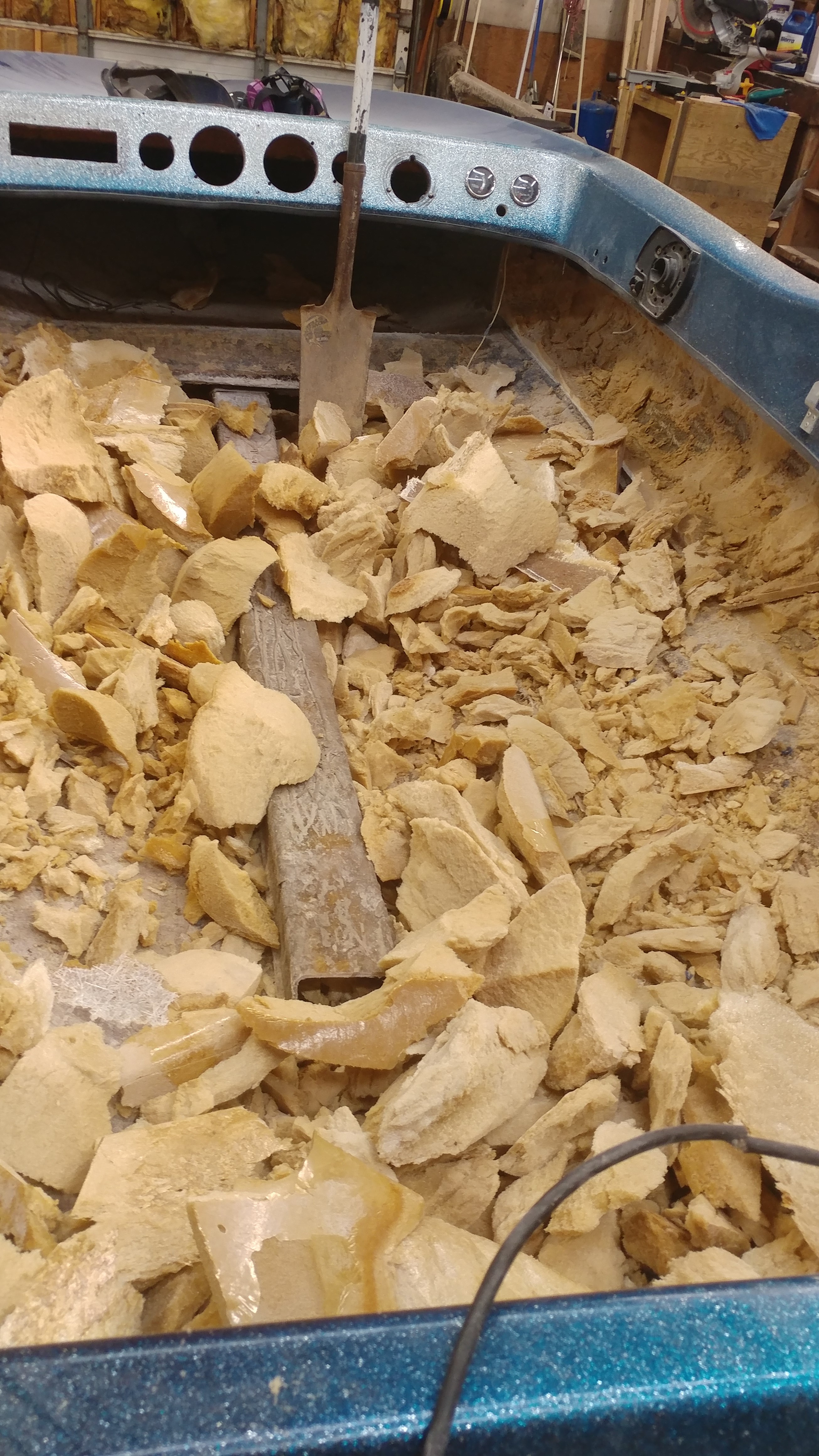

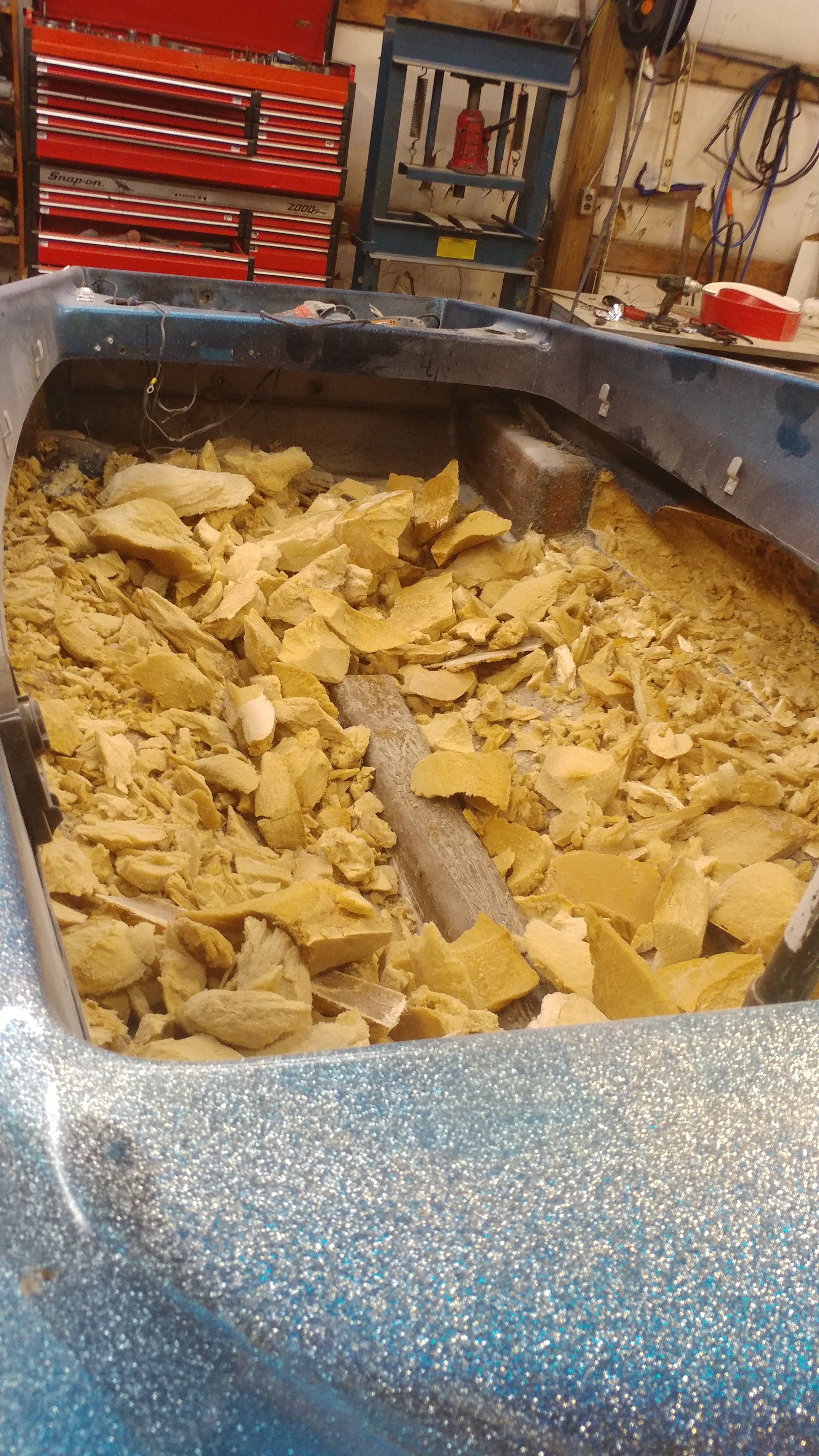

Well i have been meaning to post pics of what my vector started out like for some time so here it goes.
Bought it July 2017. "Great Stuff" pics tell all...
Finally started the removal process in late October. Grind, scrape, pry a little here & grind some more.
Will post more once i get time to give a little info as to my thought process during some of the process.
Its amazing how much foam is in there once you start digging it out. I wont be putting any foam back in my Vector when I get around to redoing it.
Definitely a lot of foam. Wet, heavy foam. I didn't put it back. Planning to use the area they were occupying for a cargo/grocery net type storage. Fire extinguisher, nav lights, small cooler or 2. Thinking about glassing in an insulated cup holder for each front seat. Lots of ideas but one can go overboard & create clutter adding too many extras.
