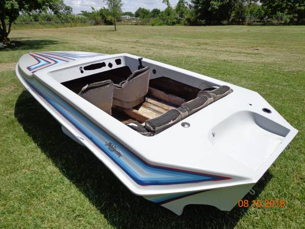

Looking at a Vegas XT the the hull and top sides are in nice condition. The transom looks solid. My question is the interior. It has the original buckets and bench seats that do need re done. The floor is out and my questions begin here. It has a fiberglass grid stringer system that is loose from the hull that would need to be glassed in.
Could there be a reason that it is not attached to the inner hull? Or is this something that happens? My plan would be to glass in the stringer system back cut the tops of the stringers and fill with pourable foam and glass back. The floor would be 1/2 marine plywood glassed on both sides and then glassed down and carpeted or sea deck.
Welcome comments or ideas on my plan.

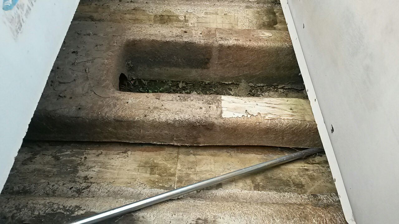

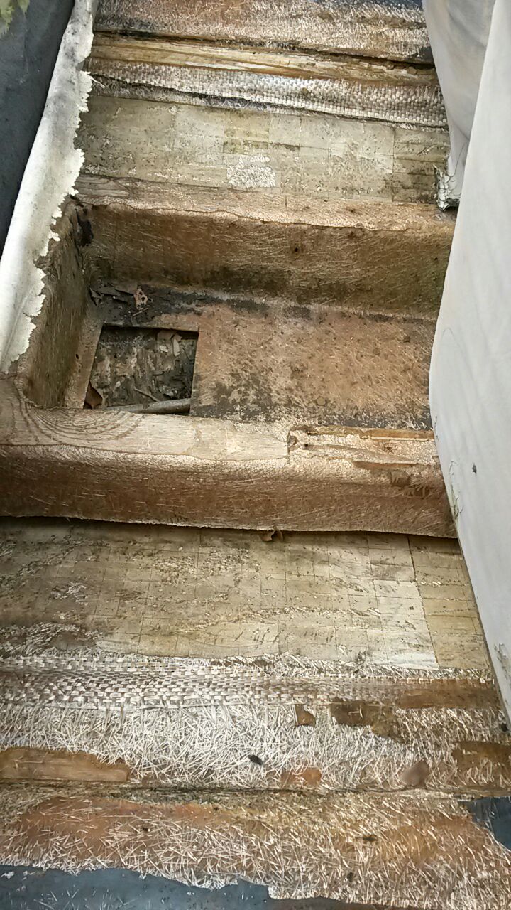

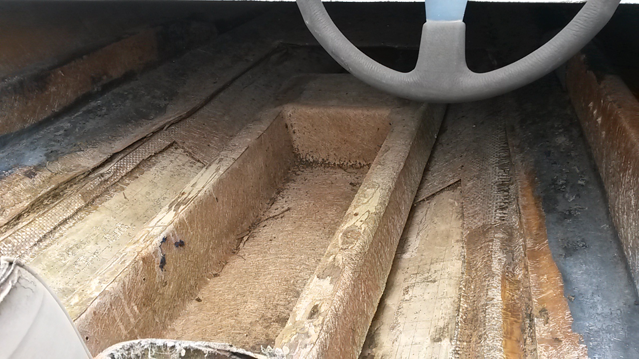

Got some more pictures show the stringers
Since its my 1st I'm not sure I'm missing anything.
Are there additional stringer or does the floor rest on what's there?

As far as I know, these boats had a balsa core, and wood stringers, all encapsulated in fiberglass. I think that’s probably what we’re looking at here. When built, they would cover the stringers with fiberglass mat and fiberglass resin. On the second picture straight down from the steering wheel spoke you can see were someone cut the fiberglass mat cover to expose , what looks to me like, scored balsa. As far as the stringer, it looks like it may have had wood in it at one time, if not still. At this point, I’m hoping someone else will comment. I have probably missed some things.
