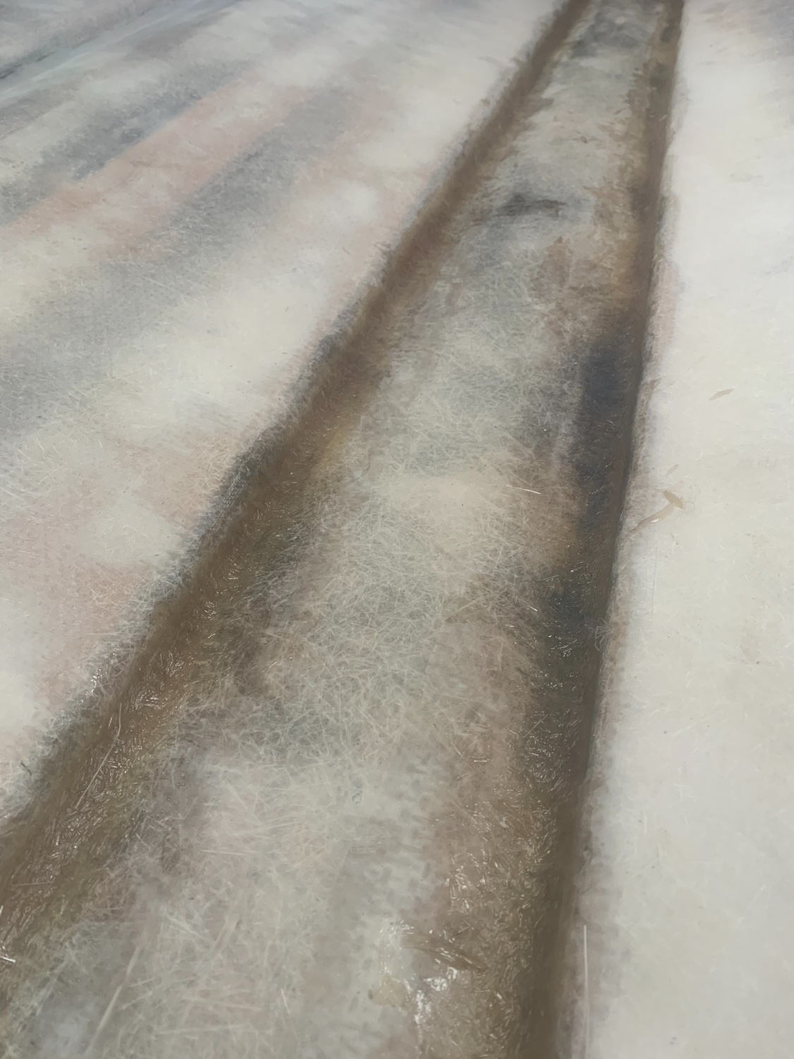

Well, got the hull ready for glass, mixed up some resin and 1/4 inch chopped strand to make a good radius in the pad area. Gunna start under the deck with some 1808 in the morning. Talk about a tight space to work😬😬

BronsonC wrote: Apr 23, 2022 7:20 pm Well, got the hull ready for glass, mixed up some resin and 1/4 inch chopped strand to make a good radius in the pad area. Gunna start under the deck with some 1808 in the morning. Talk about a tight space to work😬😬A70D3E52-432A-40D1-87D4-C665DA4E0BB1.jpeg3EBD12EE-84D7-44EA-9FC2-75BB58BF63CB.jpeg422E6694-677D-4213-8F2A-6BDEC7D61267.jpeg
