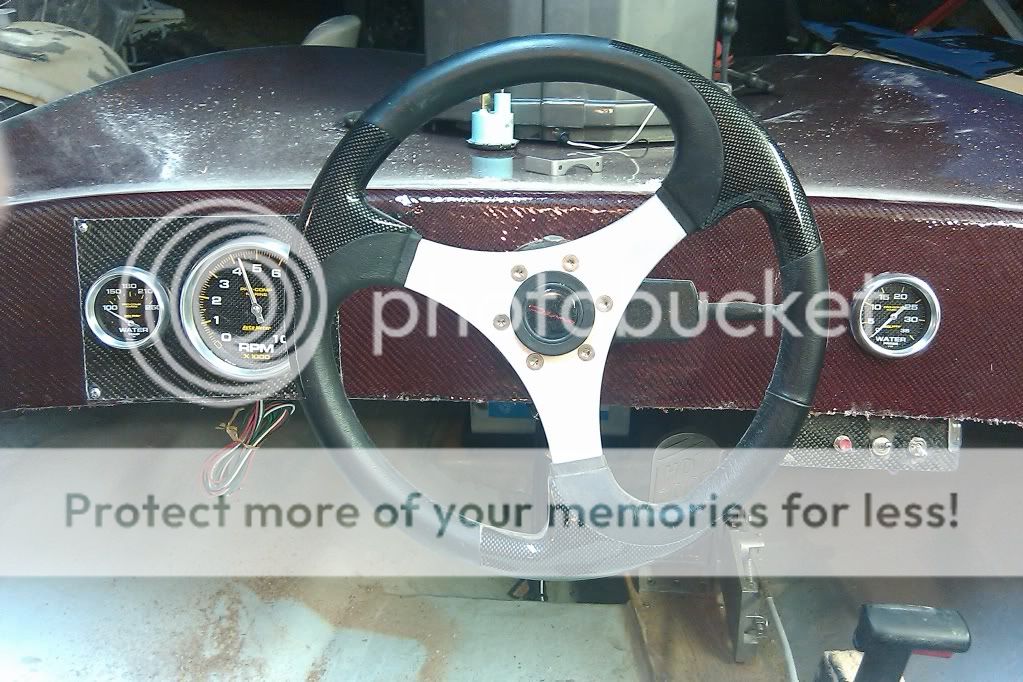

I got frustrated with the digatron gauges so I ordered some autometer and hydorodynamics gauges. I had to fill in the hole in the dash so I made a panel to cover the hole, I think I need to add another to the other side.
I'm still waiting for them to build my fuel pump for the methanol system so I haven't tried the gas. I did get to take it out last sat with my 22 et and found I need to so something with the vents. If I accelerate hard the fuel sloshes into the vents and it stalls the motor. I just got a set of wmh 20s to replace the 31s so I will lower the fuel level and bump the pressure to see if that helps otherwise I think I will add slosh tubes.
The boat is a absolute blast to drive, well worth all the effort!
