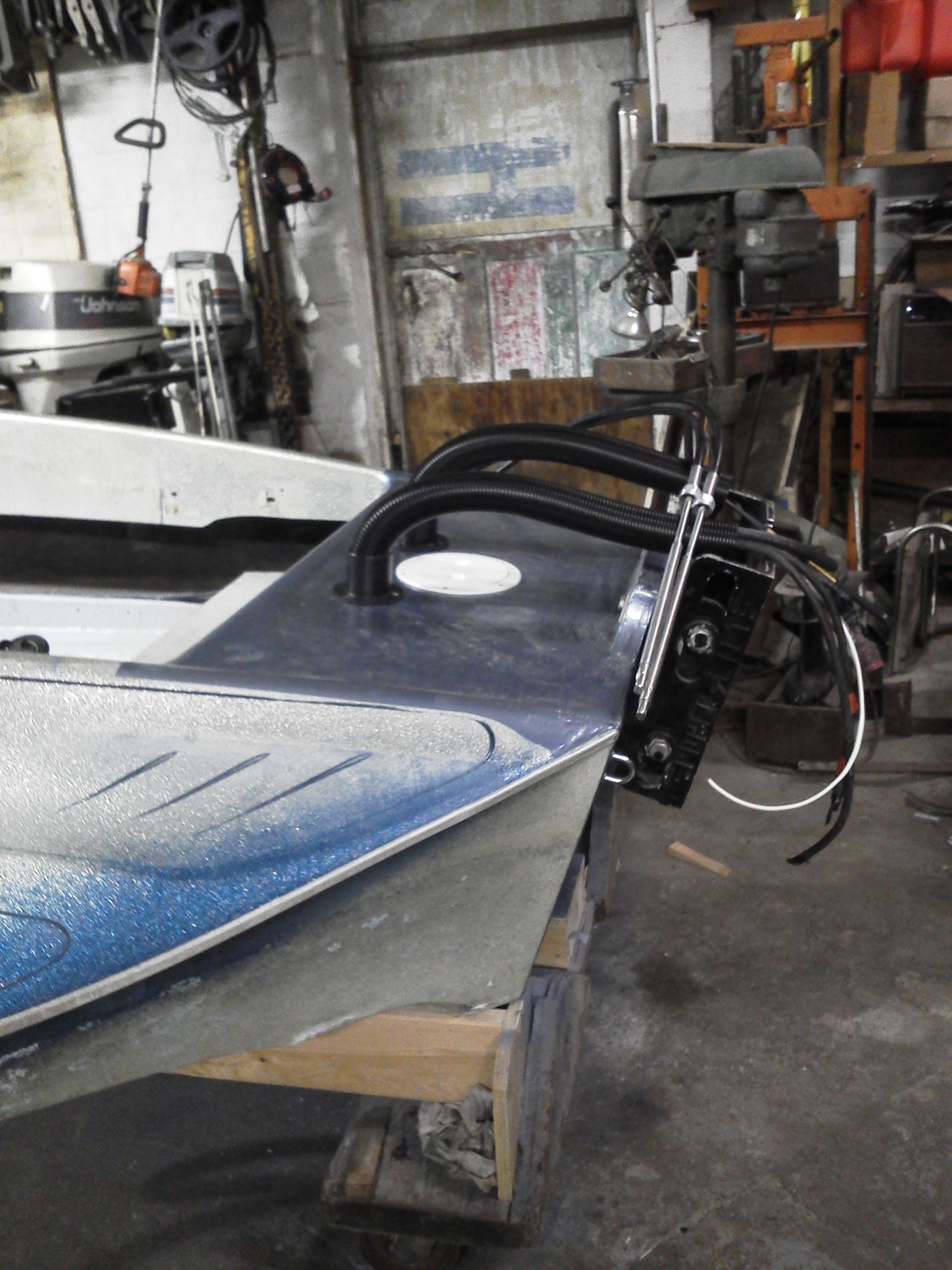

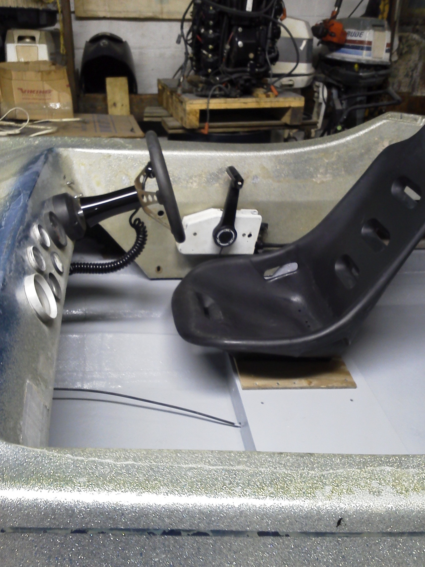

Well its almost done for now. The shop that is letting me use there place is starting to get busy and I have to get it out, so this is it for now. The seat is just temp. I plane on getting new ones but needed something to sit in for now. I will be looking around for somebody that can paint the rest of the boat at a decent price or I will be learning how to paint real soon.

Re: VULTURE recore
Dang!! Your cooking right along. Looks great!! The way you routed your throttle cable gives me an idea.
