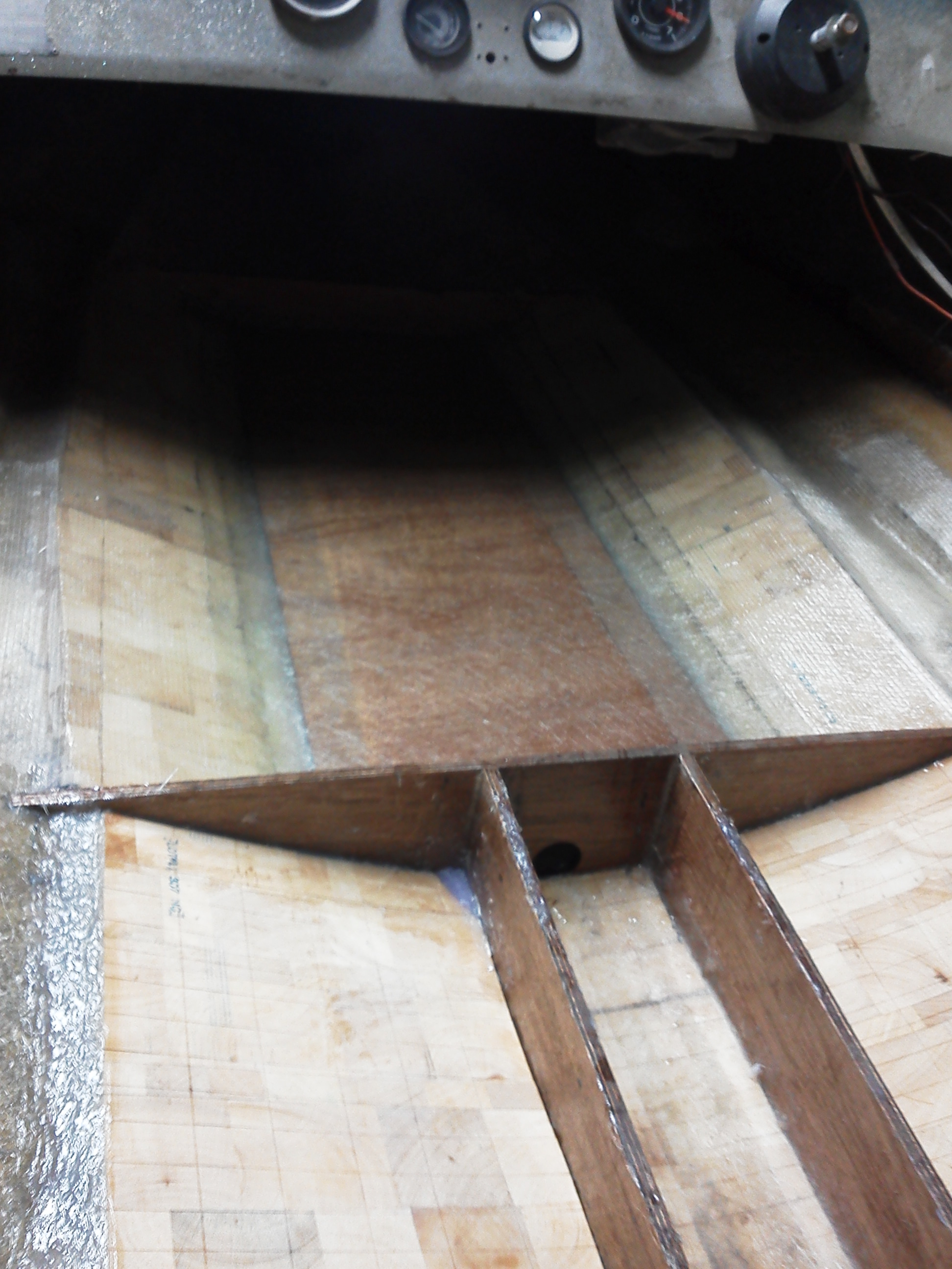

Here is the latest update. The core in the front is all glassed in and done. The core in the back is all glued down and will be glassed over today I hope. I am almost out of resin and dont think I have enough to do the whole job so I am going to wait. More has been ordered and should be here today. Hippie, just a reminder, I know you had to stop working on yours for a while but before you put your floor on make sure you drill a hole in the back of your stringers to let any water that might get under the floor away to get out.

Today I painted the inside of the boat with a expoy paint,this stuff dries hard as a rock. Then I glued down the front half of the floor.I left the back half out because I need to drill and bolt the L brackets that go on the bottom of the vulture. I have to change mine because they were pretty much rotten away. After I bolt them in I will glue the back half in. I am going to try the boat with out putting the vacuum tubes back, If it don't break loose I can always redrill them.
