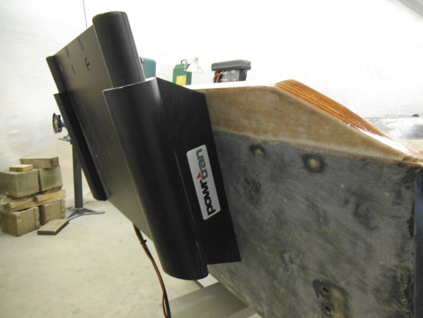

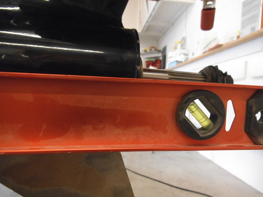

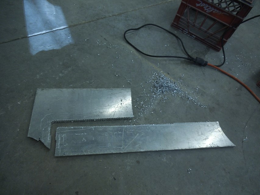

Had a piece of aluminum left from another project. Was large enough to use as a transom saver.

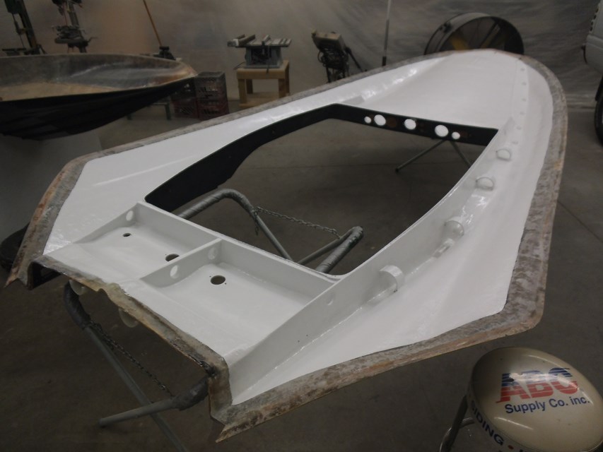

Re: Viper rebuild

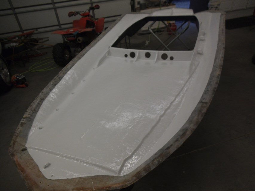

The underside of the deck was painted with Rustoleum Top Coat paint. Going to lay out the wiring for the dash while it is upside down, and much easier on the back.

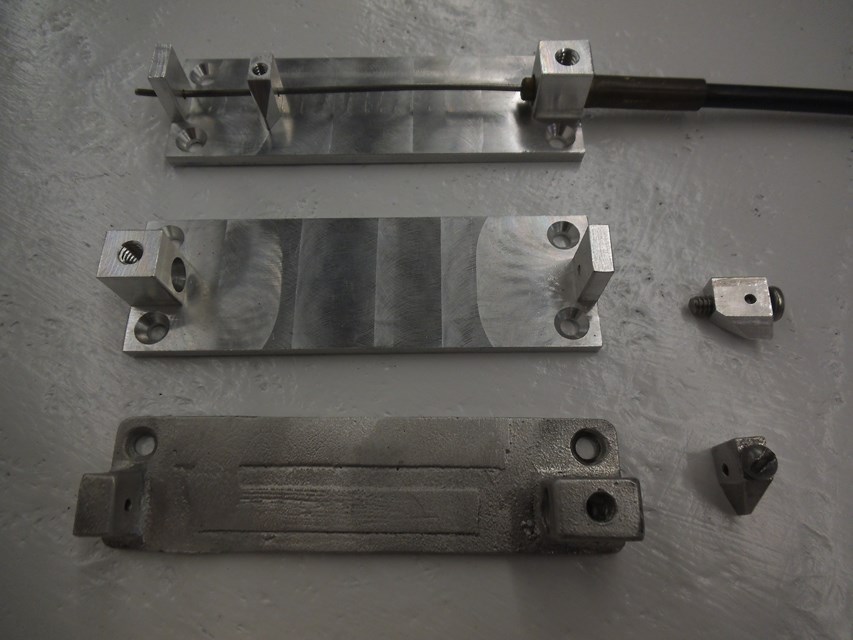

Made some mechanical trim gauges and glassed some bulkheads to mount the GPS antenna to.

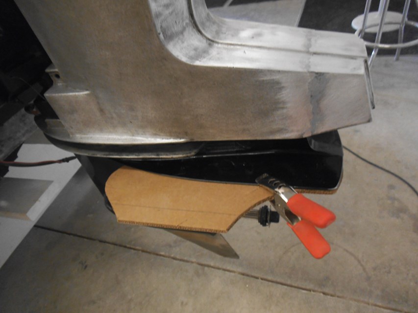

Picked up a piece of T-6061 aluminum to make a dragplate. Mock up of the cardboard template. It will bend downward at the drawn line.

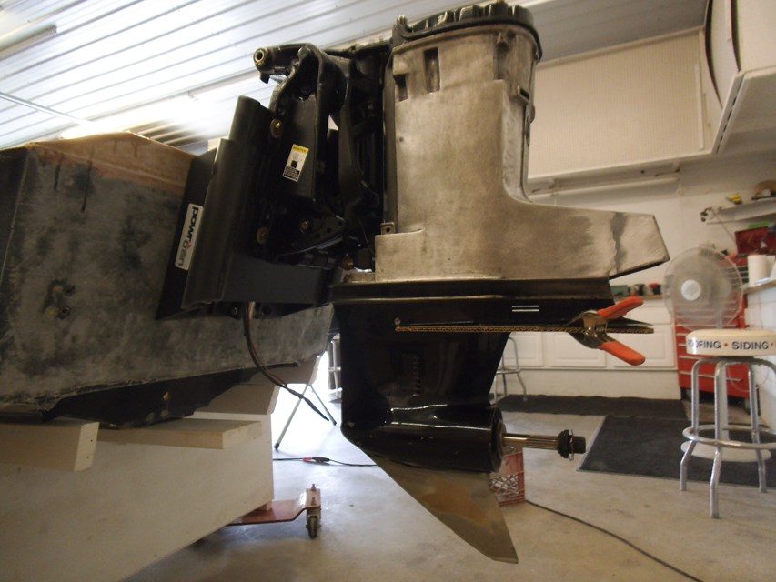

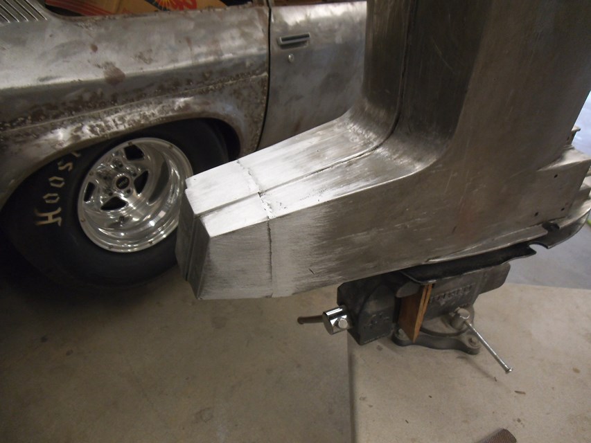

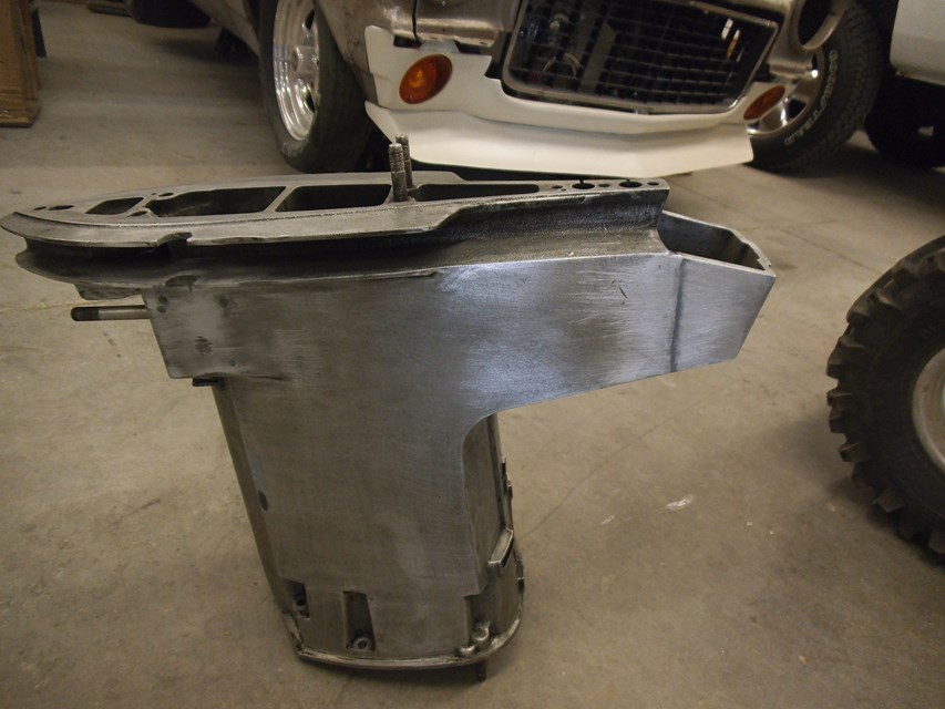

Picked up this 20" Offshore Ridgeback on S&F for a good price, The exhaust snout had been hacked off, but not discarded. Welded it back on and it will get a treatment of Zinc Chromate and Phantom Black. Will use the second hole from the top on the motor mounting. It will have enough travel to go 1.5" above the pad and 2.5" below...should cover my needs.
