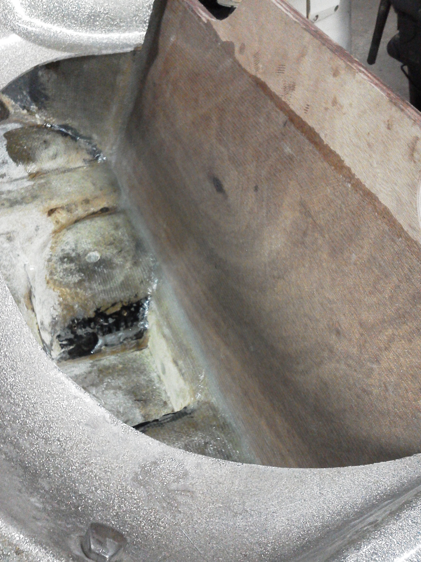

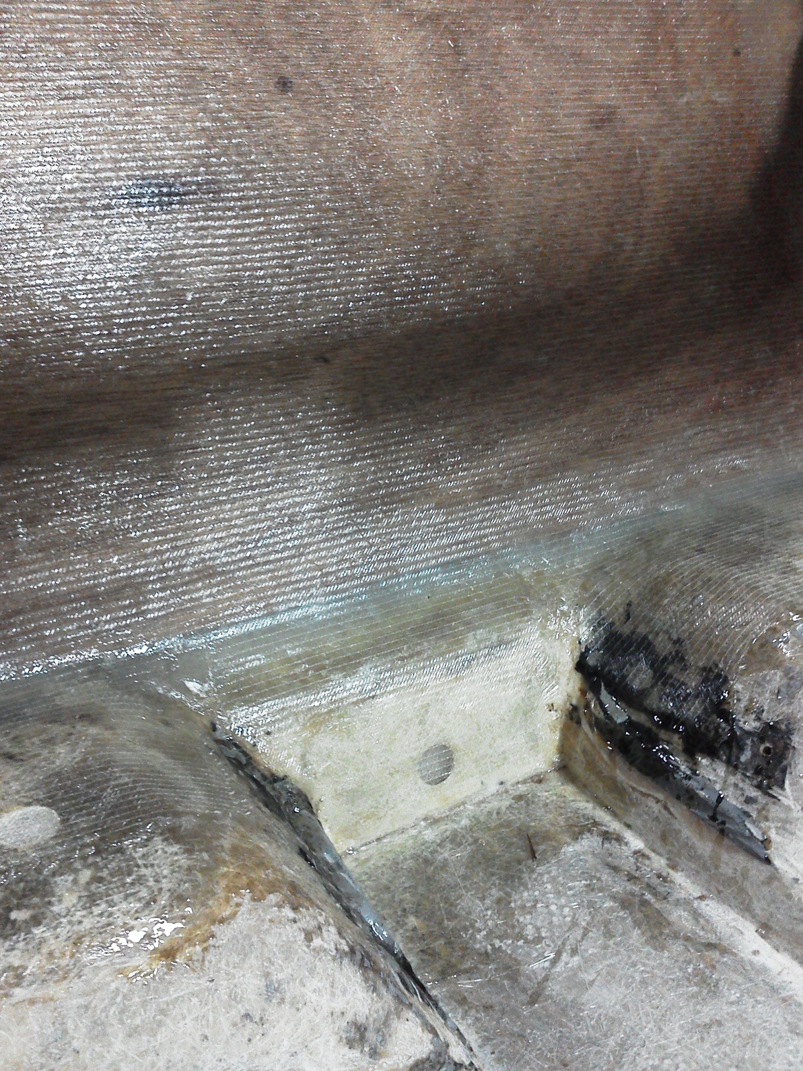

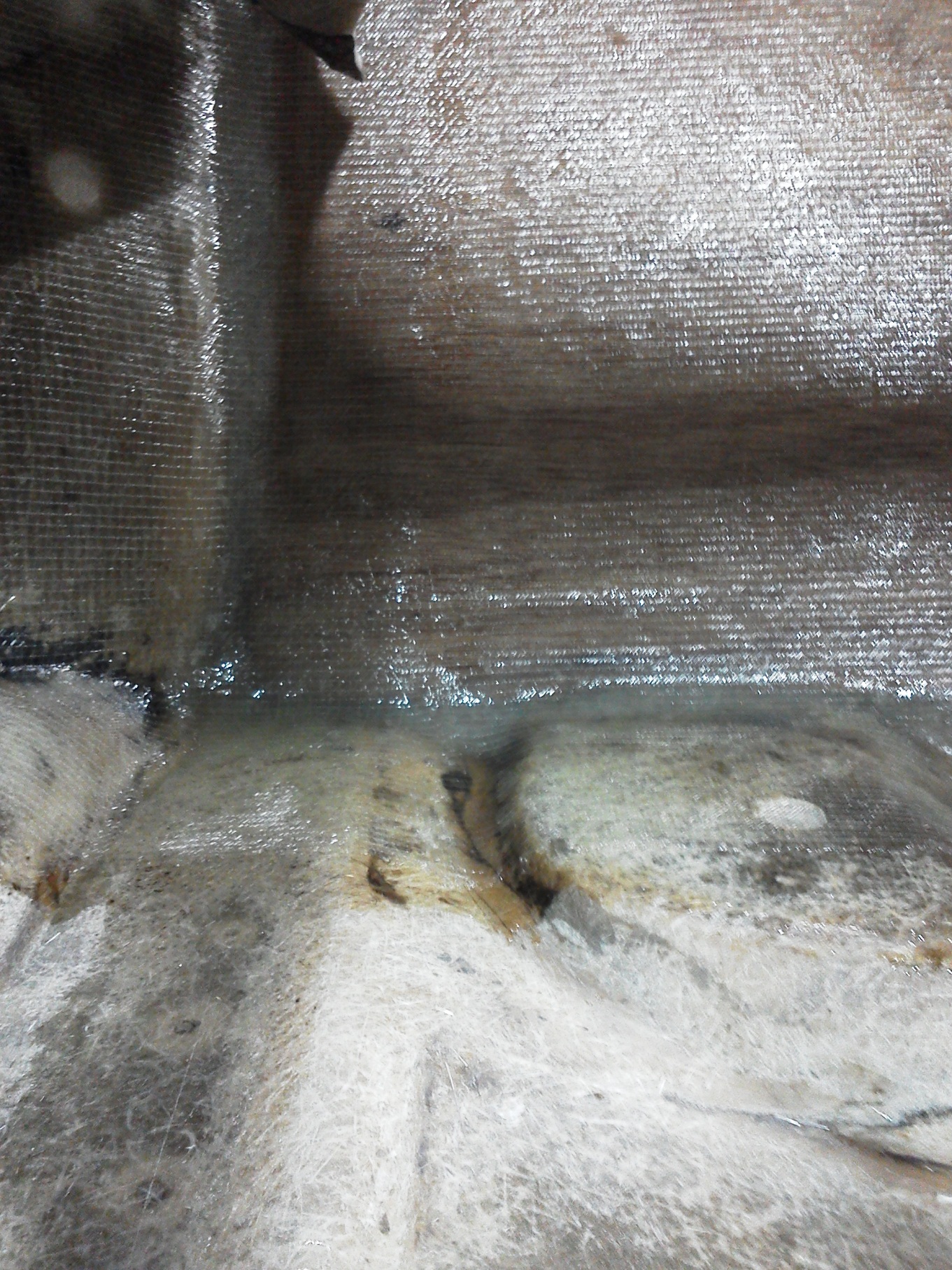

Well, got some more work done on it today. Got the transom in and glassed, and cut the stringers. I used 3 strips of 1708 cut to 6" wide, one went on the bottom 3" on the floor and 3" up on the transom the other 2 went on the sides in the same way. ( thanks Chet ) Then another layer of 1708 6" past the side and across the transom 6" past the other side. So there is a 3" overlap over the first piece. Hopefully tomorrow I will get 2 layers of 1.5csm on the pad and the stringers set in place. Wishfull thinking......

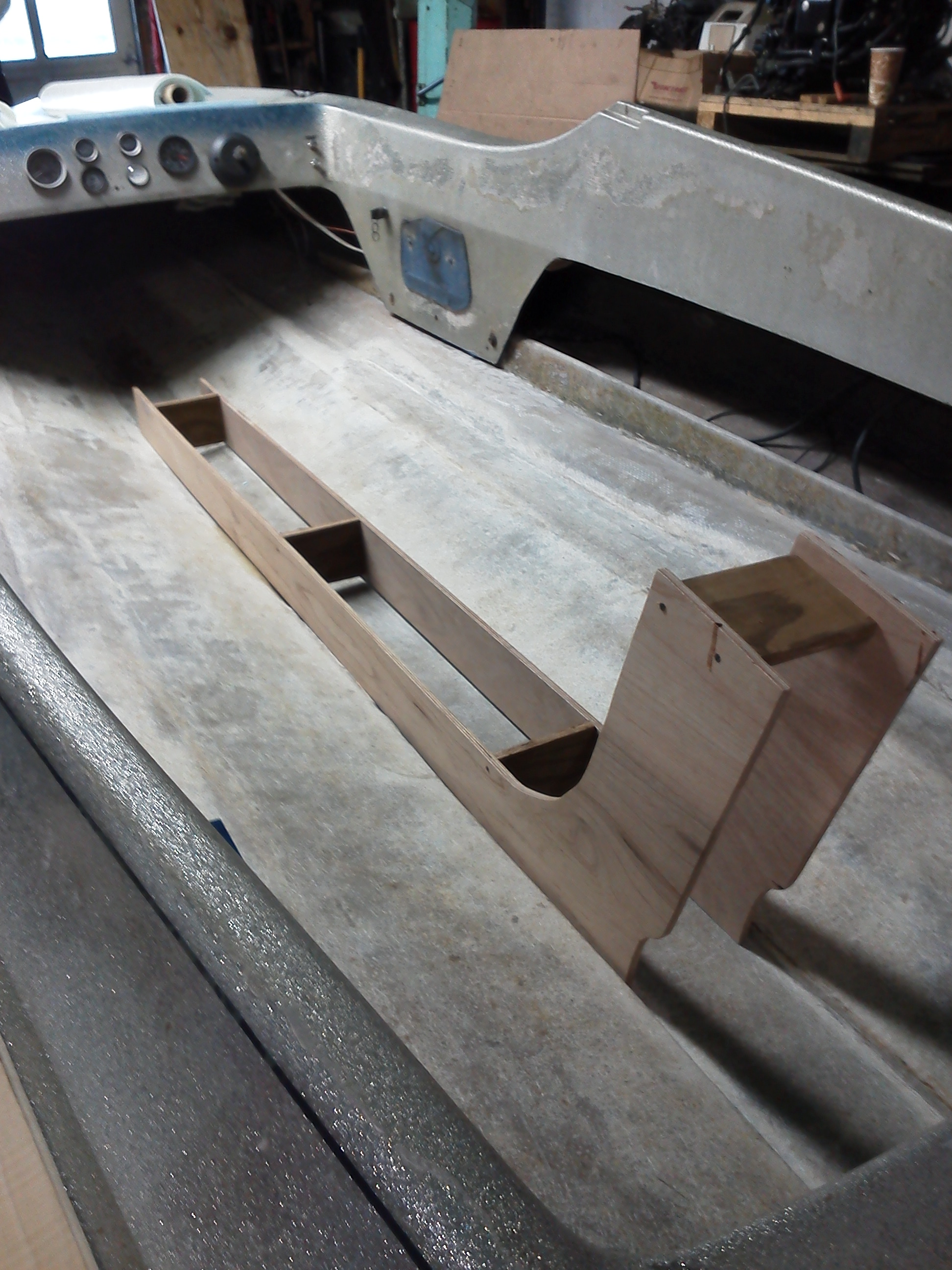

- And the stringers cut and ready.

LOOKS.......................... REAL GOOD.......................but I got a ?..................do the knees go against the transom........
Re: VULTURE recore
Oh man, I knew I did something wrong....... I thought they should go to the transom but the plywood was only 8 feet long and I needed the stringers to end up front so I could put the front bulkhead in........Yes they do go the transom , I just took a pic. of them. Tomorrow they should be glassed in were they belong.
