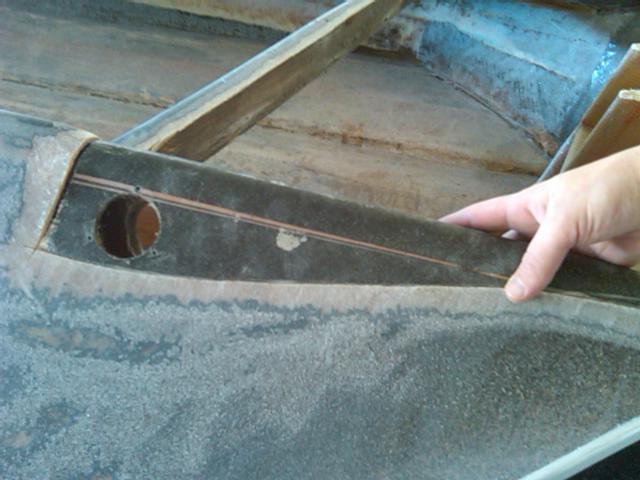

the previous owner had already cut the splashwell out on my vector when i bought it. he cut through the body line, which i wouldnt do (just created more work to restore body line and there is a structural board running through there the lenth of the gunnel)
i. filling body line.jpg (42.87 KiB) Viewed 8445 times
more pics on how i replaced splash well somewhere on here
