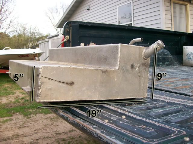

Here is the gas tank and wondering if there is any way to figure out short of dumping something in gallon by gallon to figure out what size tank this is off the measurements.
Also, Anyone know where to get a new sending unit for this? I am thinking of going with AutoMeter gauges. Wonder if they would have one that will work.
That black mark on the one side is a grease mark and its not a crack. Also, The little top section is 7 inches wide. I forgot to mark it in the picture.

20 gal.
Unusual shape though. Did it fit under the back seat somewhat? Looking at your earlier pics, I can see transom braces that would prevent it from being mounted all the way back to the transom. I would have guessed that the factory would have mounted them way back, but your fill neck position adds another kink to my forensic query.
What do you think?
Also, when I had my tank out, I wanted to know whether 1/4 tank on the gauge was 2 gal or 6 gal. So, I did fill it, several gallons at a time, marking it's level on a dip stick. I compared it later to the gauge after I got it wired, months later. If you want, you can gather a bit of info about you tank filling it from empty, that you can't once you put some gas in it. I'll bet your gauge is gonna act somewhat goofy due to tank shape.

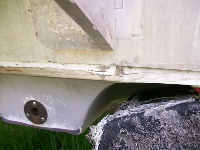

And now for the bad news of this whole thing but it has not stopped me from finishing this project, Just a little bit of a new direction now.
The neighbor guy came over today to check it out and while he was there we moved the boat around on the trailer so I could get a better look at things and I didnt like what I found.
Now I have not had the boat off the trailer myself so dont get on me to much about this.

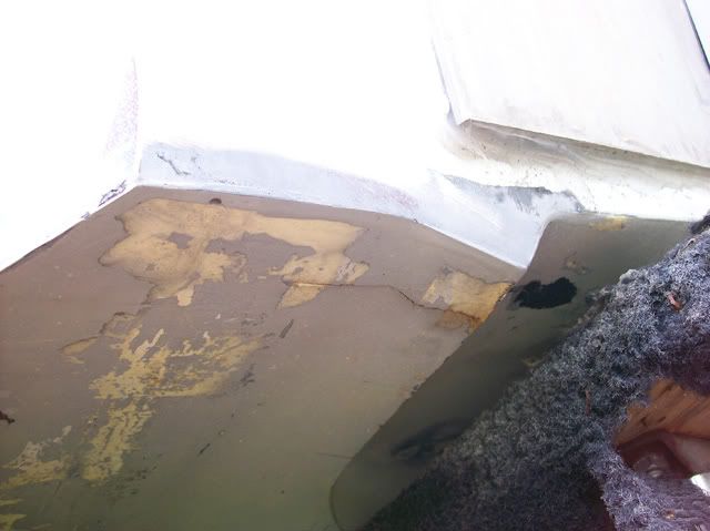

First I had been looking at some of this silicone on the bottom of the hull/transom area and decided to peal some off (Alot of it actually) and this is what I found under it.

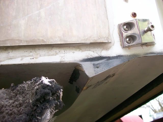

After finding that is when I decided to enlist the neighbor to help me move this around some and look at this...
I really dont know what to say other than...
I dont think the motor will be going on as soon as planned. And as for my fiberglassing skills, Never done it once in my life. Anyone want to take on a project for/with me? The cheaper you are the better.

Wow, that sucks! That looks like stress from a big motor. Can you see anything from the inside? Is the core intact? Thats going to make a big differance in repair cost. What a bummer
I'd help if I were closer. It's a long walk. Even if you have to cut some floor, see if you see anything from the inside. Let us know.
