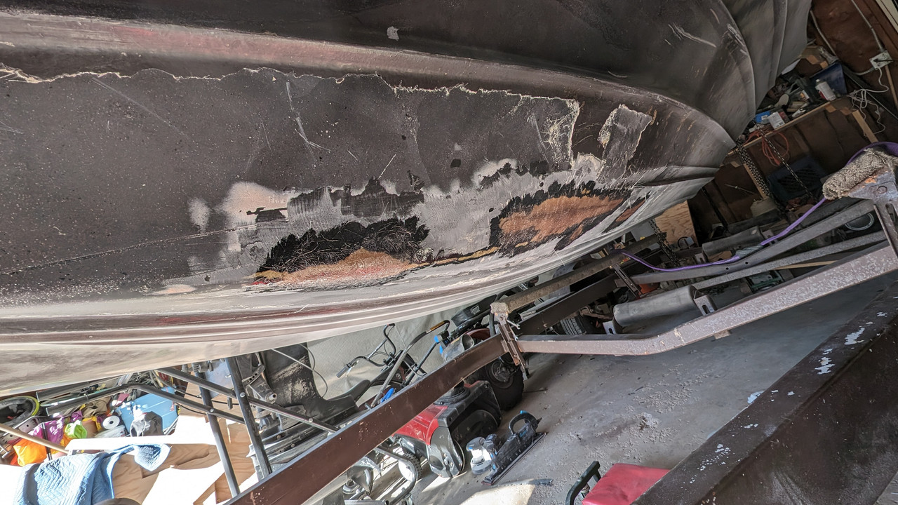

I got it all fixed up, put 10 layers of chop mat and a layer of 1808 structural glass between all the chop. A good amount of the chop will get ground off, but the spots that I cleaned out for the repair should have nearly all the layers in there.
Took me less time to do the repair proper than the last owner spent with the house paint and roller on the bottom.
Still need to finish cleaning off the old crap glasswork, then I can get it all filled and smoothed out.

Cleaning up real nice here. The damage was actually pretty small considering how big of a area the last owners covered in glass.
