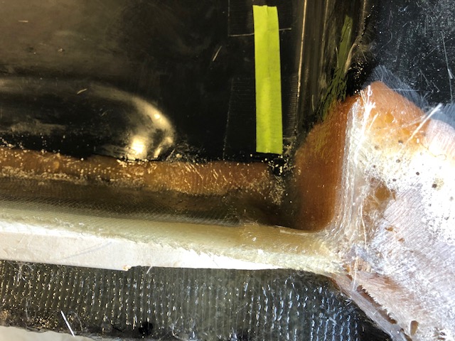

Yesterday, I got the splashwell glassed in and really went to town on the inside corners where they are prone to cracking.
I glassed the tight 90* corner first, then used structural fiberglass putty to make the new radius, then more glass. Mat and three layers of 1708

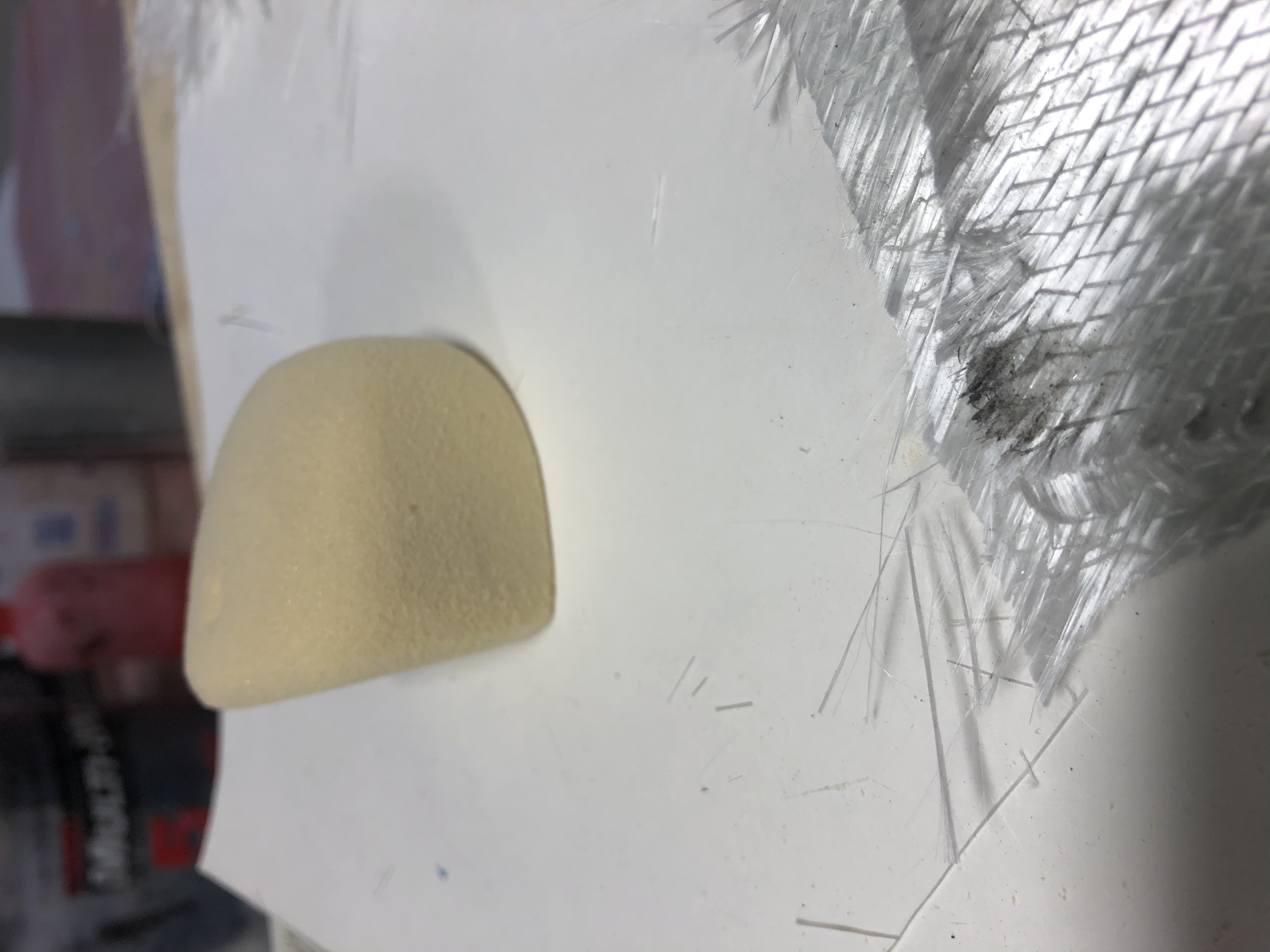

Yesterday, while letting fairing putty dry, I made a “doo-dad” for the hydraulic steering hoses. The 3” opening was just too large to have just two hoses come out.
I shaped some foam and glassed up, shaped and ready for black gelcoat.

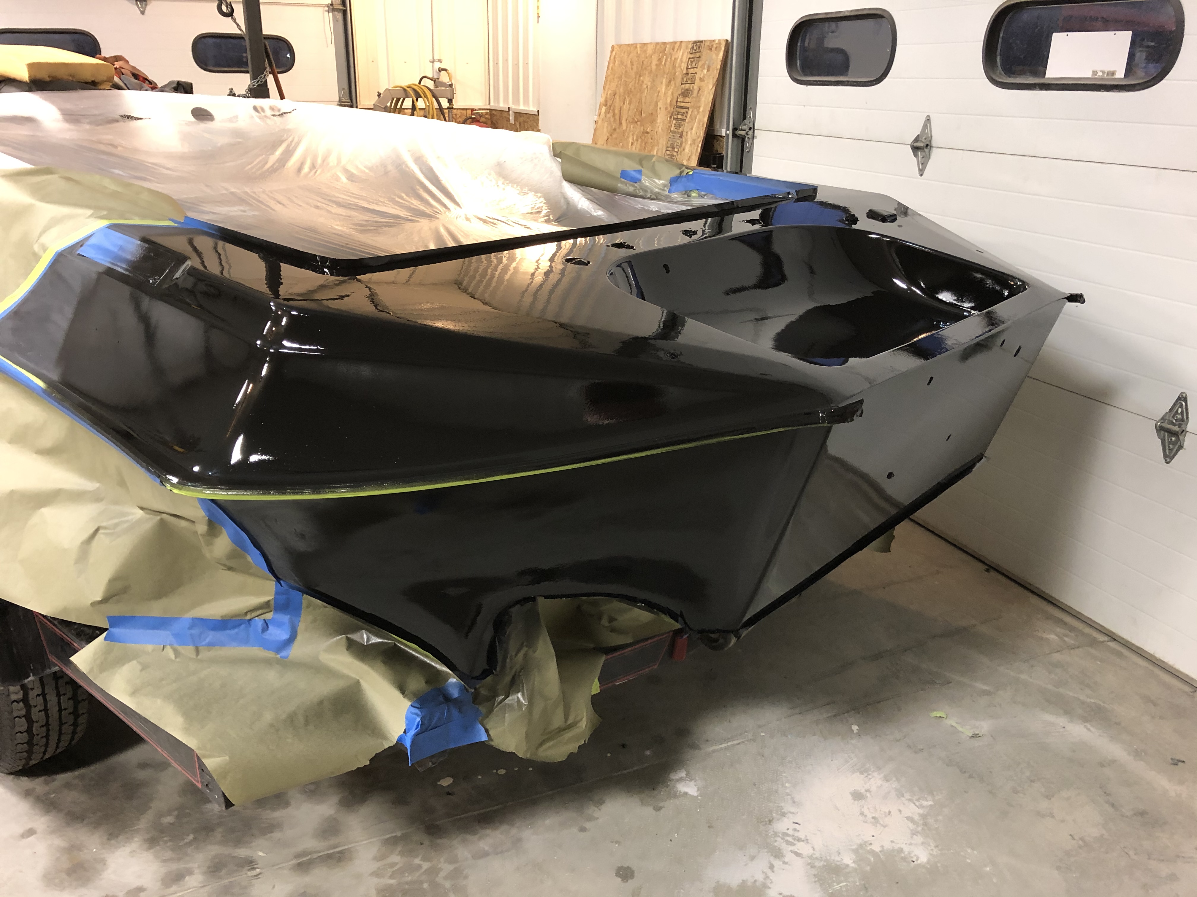

Got the black gelcoat sprayed.

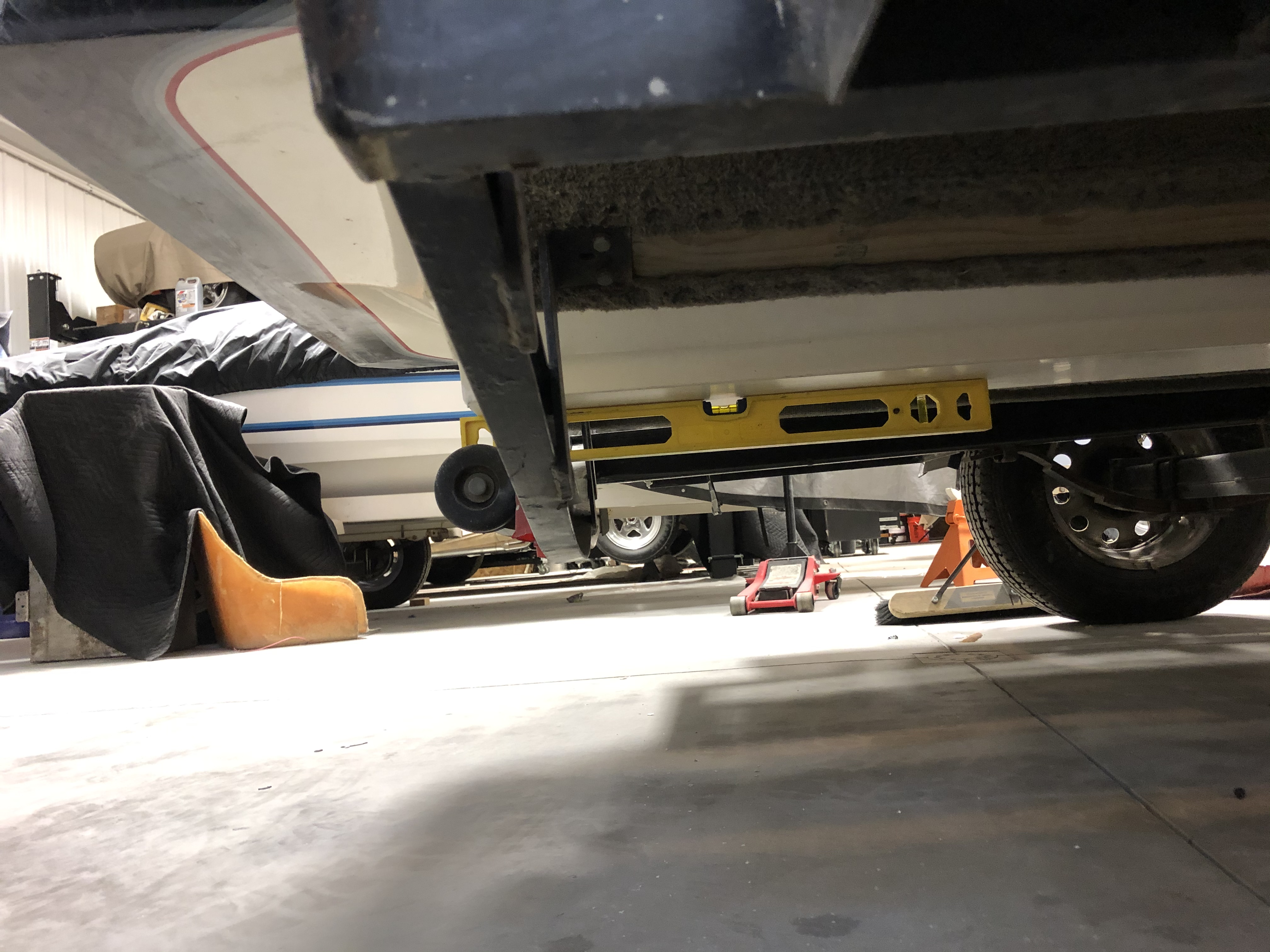

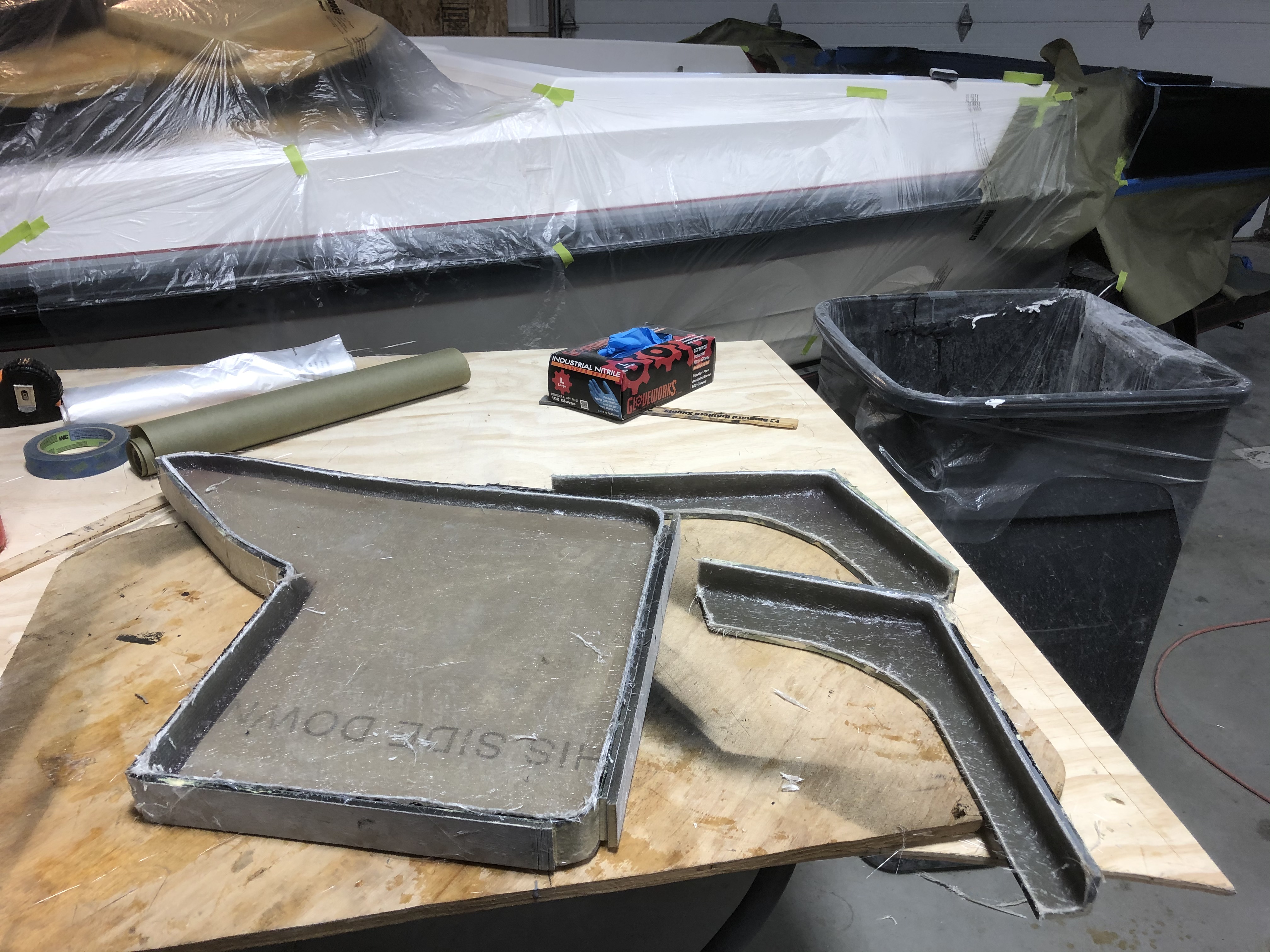

Yesterday I decided to make a swim step.
David Fatov got me measurements off his Voyager.
I leveled the hull and got my transom angle.
I am going to make fiberglass L-brackets to save some $$.
Cut a piece of foam to the shape, hot glued strips on for sides, silicone the inside corners for the radius I liked,waxed and laid up.
Got about 6 hours into this project.

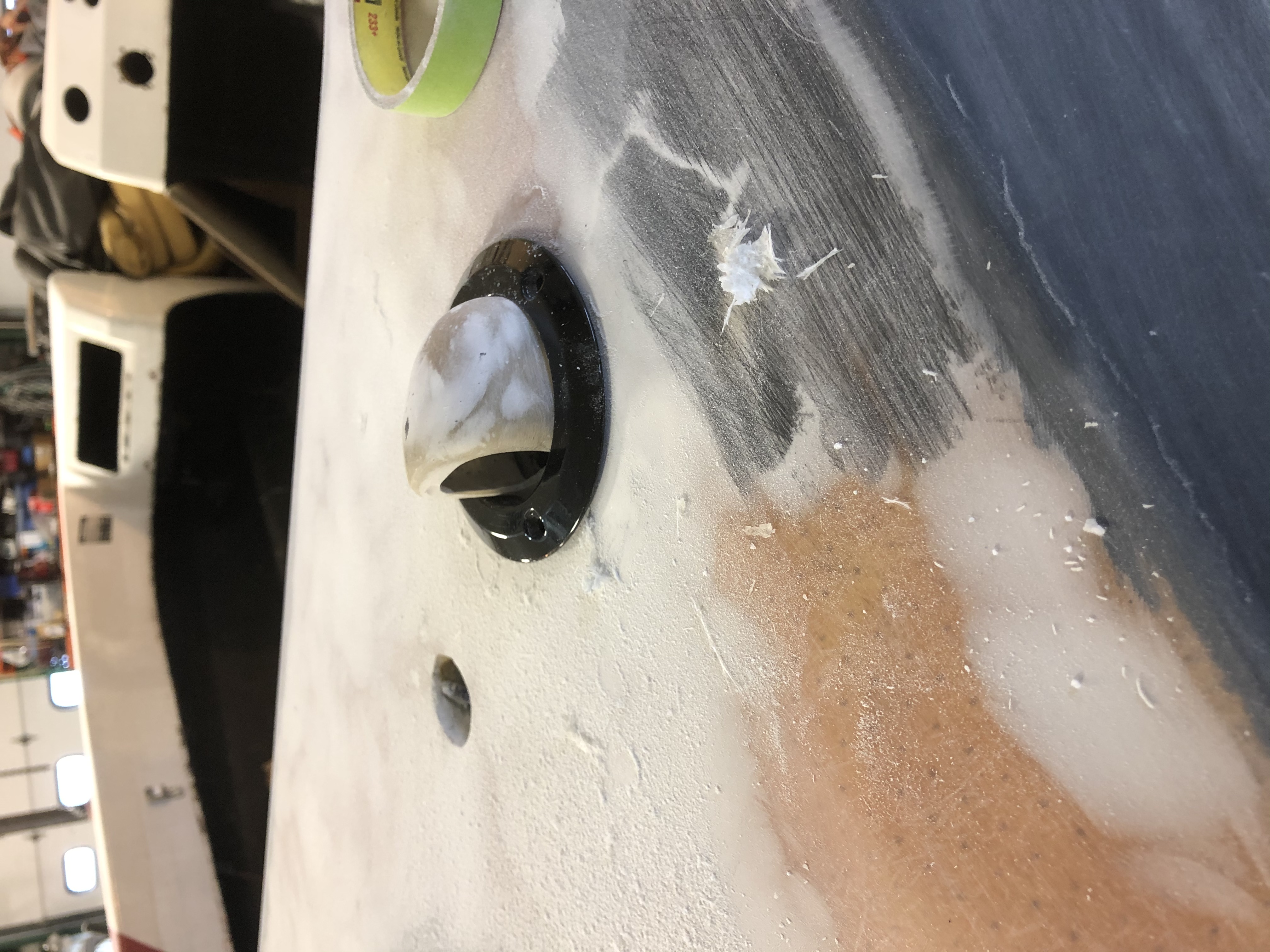

Forgot to add that I filled in a 3” gauge hole and the windshield screw holes and re-gelled these areas.
The windshield will get re-mounted and laid back like the 1990 and newer Voyagers.
