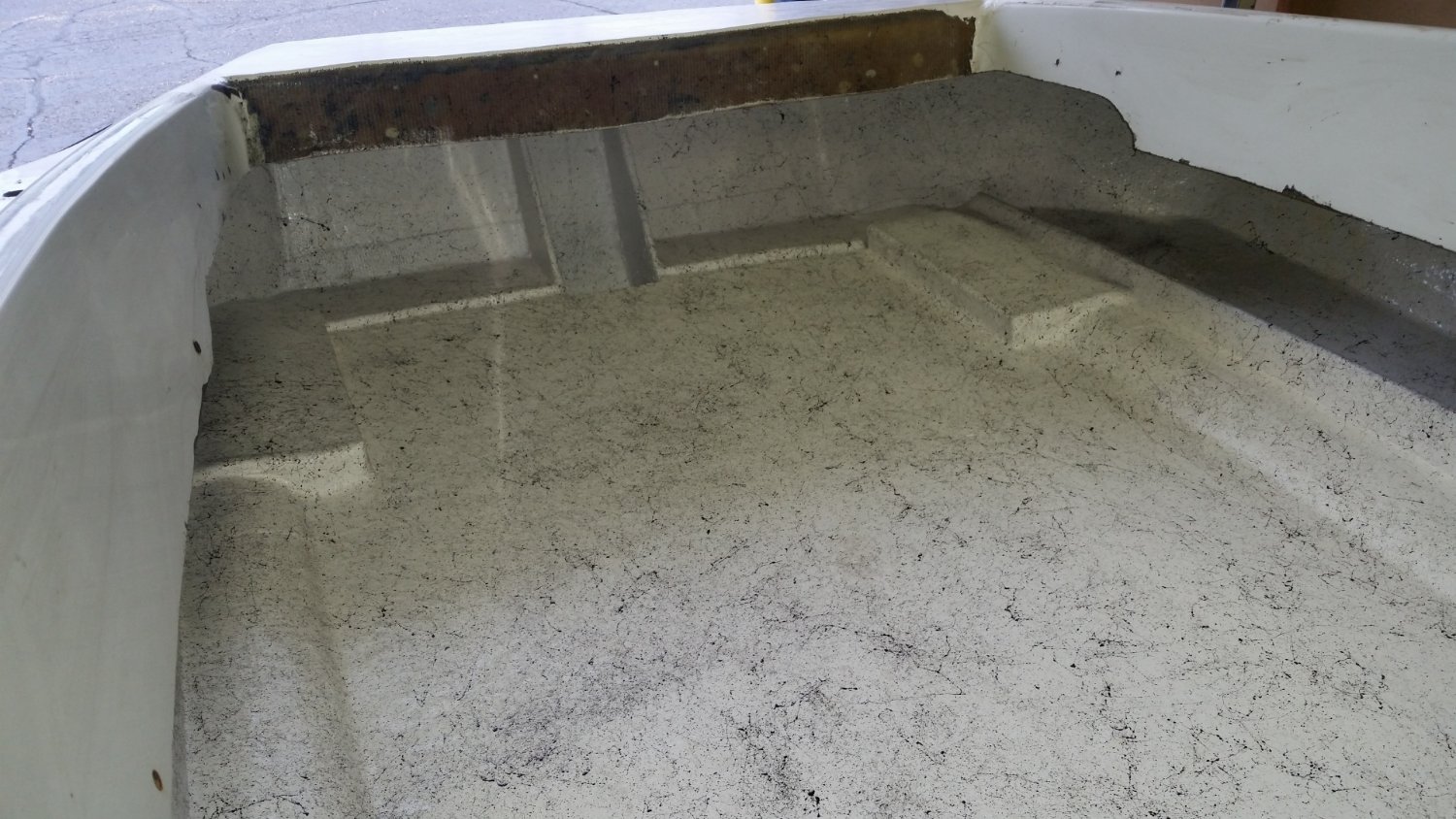

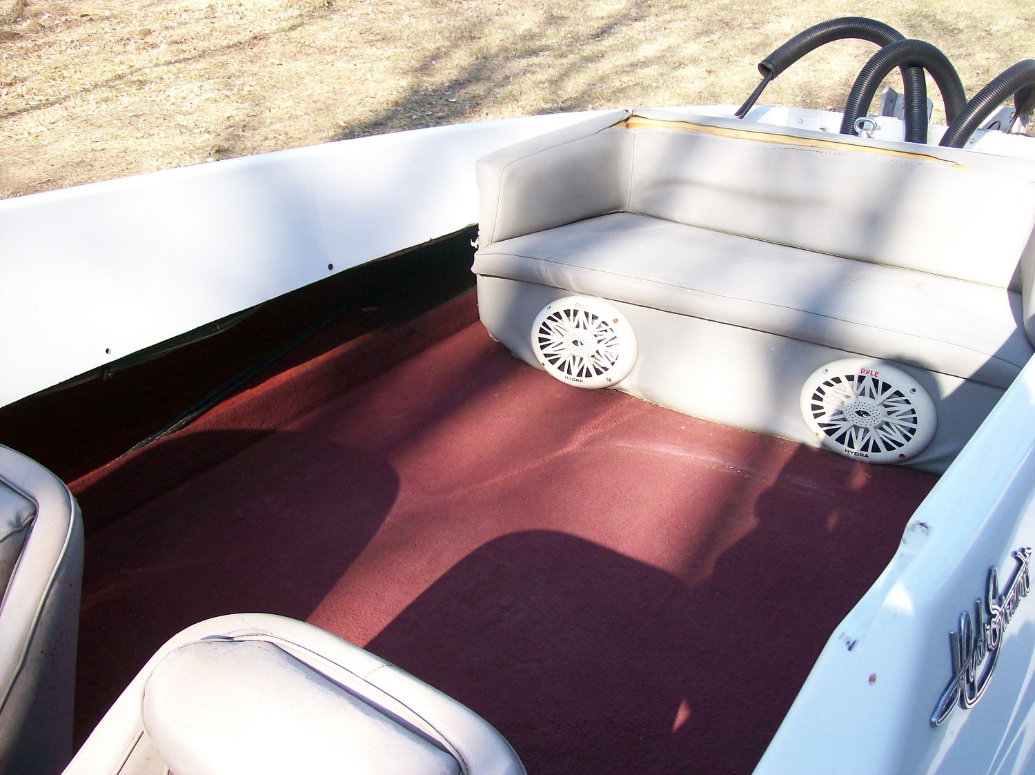

As for your other questions, I have knee braces in my vulture and my tank does sit forward a little but not a lot and also, my bilge area is not covered by my gas tank. And you shouldnt cover it even if you dont have knees. But thats my opinion. These pics are from when I just got done doing everything and nothing is rigged or mounted. I'll dig up a newer picture later. Looks 20 times better now.

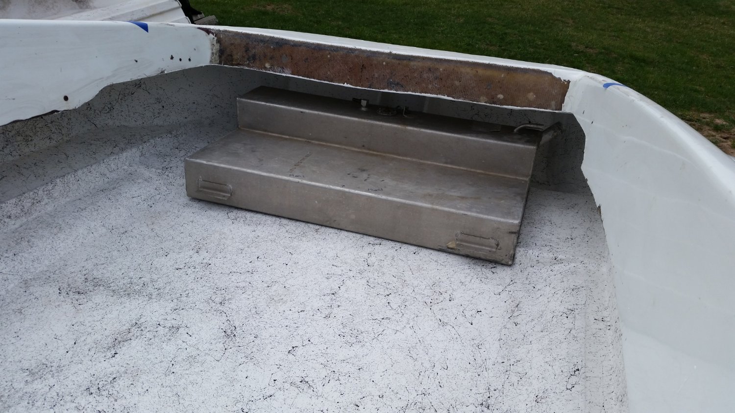

The pictures are great. Interesting fuel tank. Mine is rectangular. 28" x 16" X 10"h.

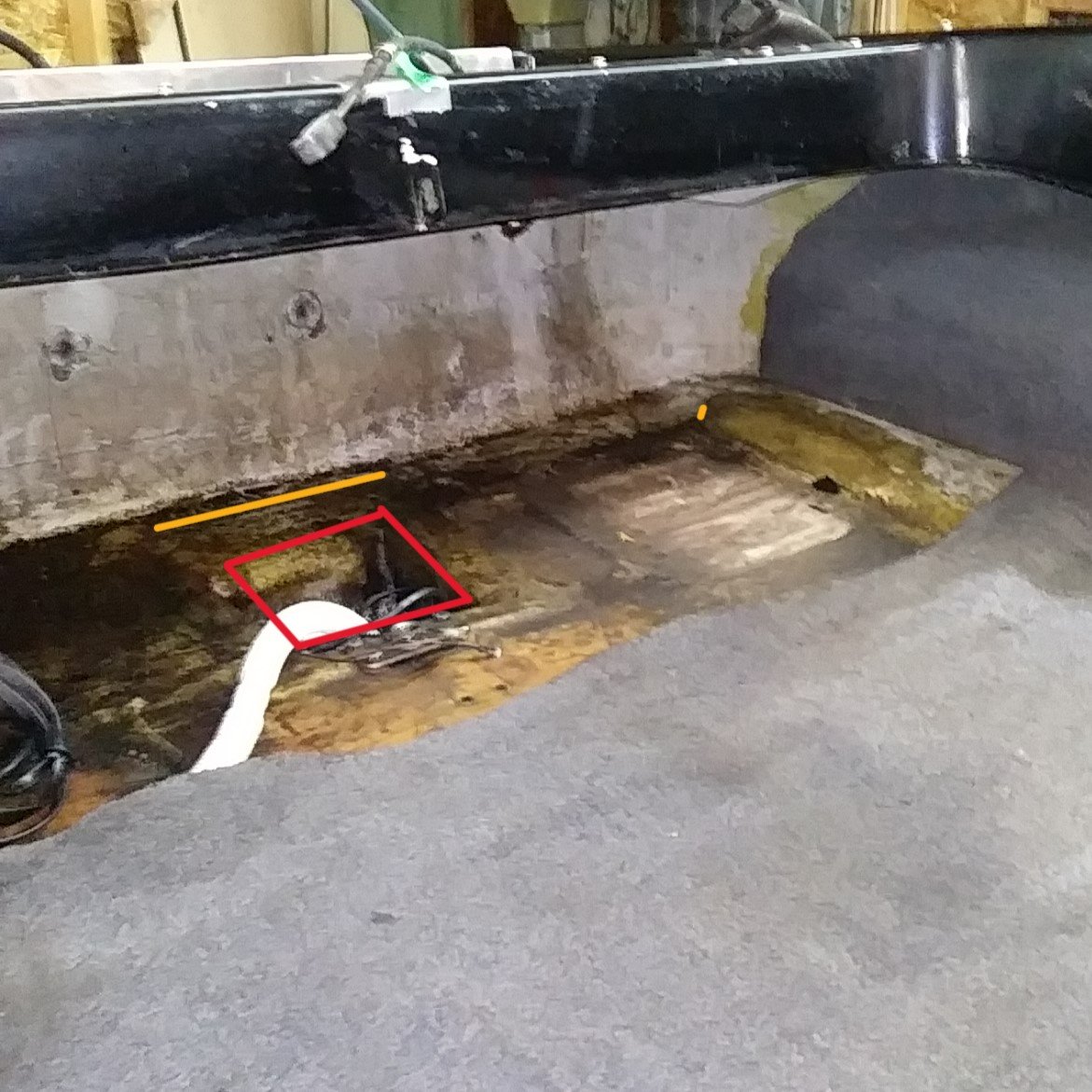

It appears that the sump location on the V-King is not the same as the Vulture. The V-King's sump is about 6" forward of the transom and about 6"x6". The distance from the transom to the rear seat is less that 20". To get the fuel tank in front of the sump the rear seat would have to move 8" forward.
The tank would probably fit beside the sump, but that seems wrong.
Is the concern with covering the sump because of bilge pump maintenance or draining water from above the floor?
It looks like you would have to remove the tank to get to the bilge pump, right?

Here you cen see how the rear bench was when I got the boat. The lower portion of the tank is under the seat base where you sit.

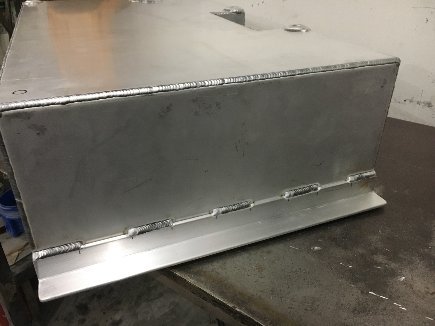

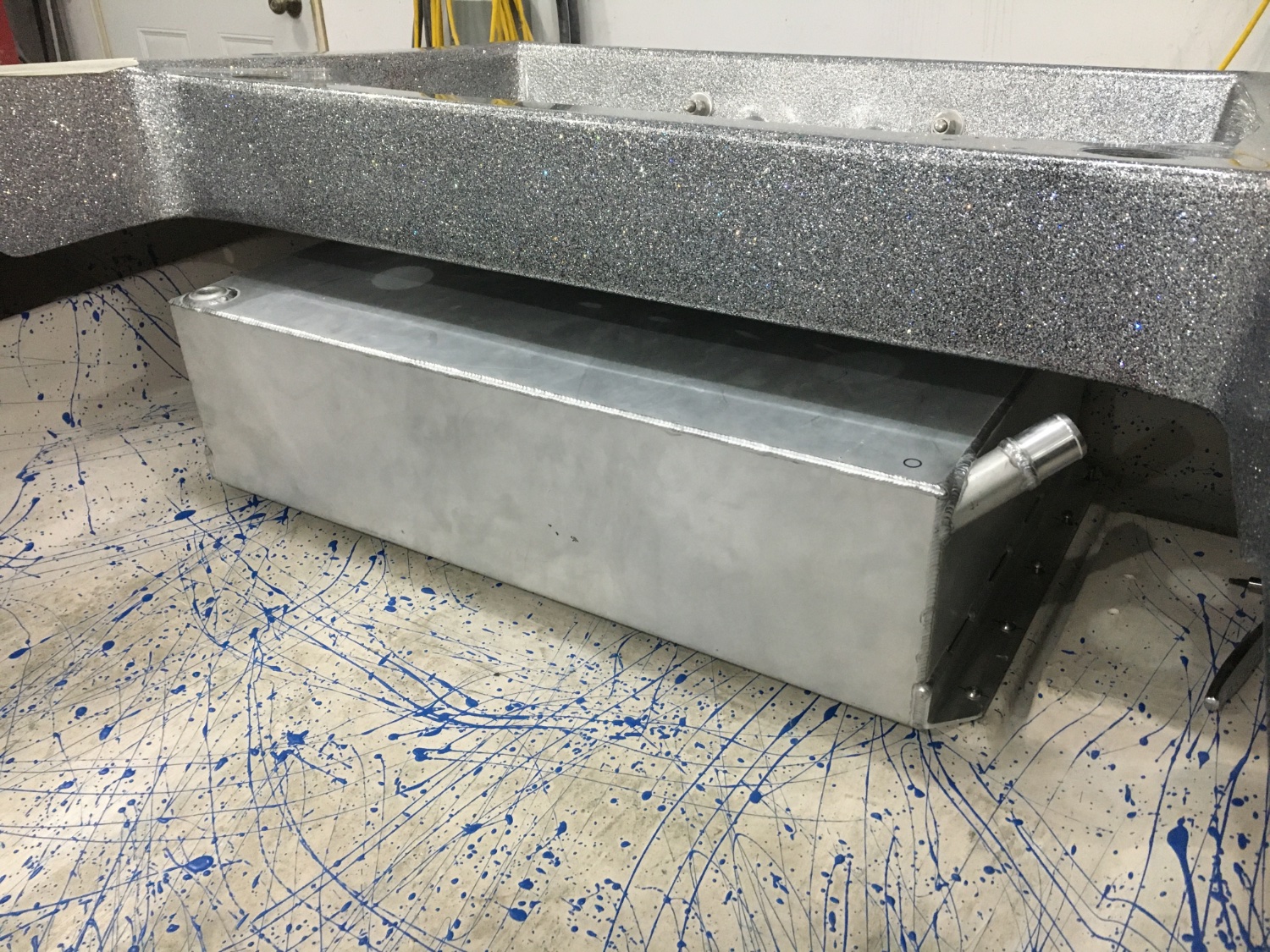

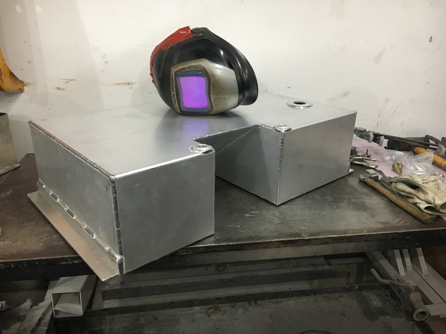

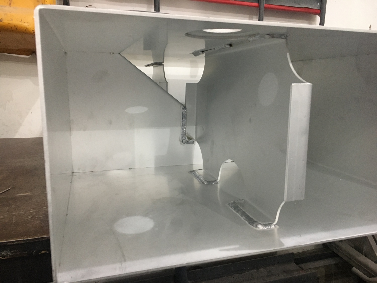

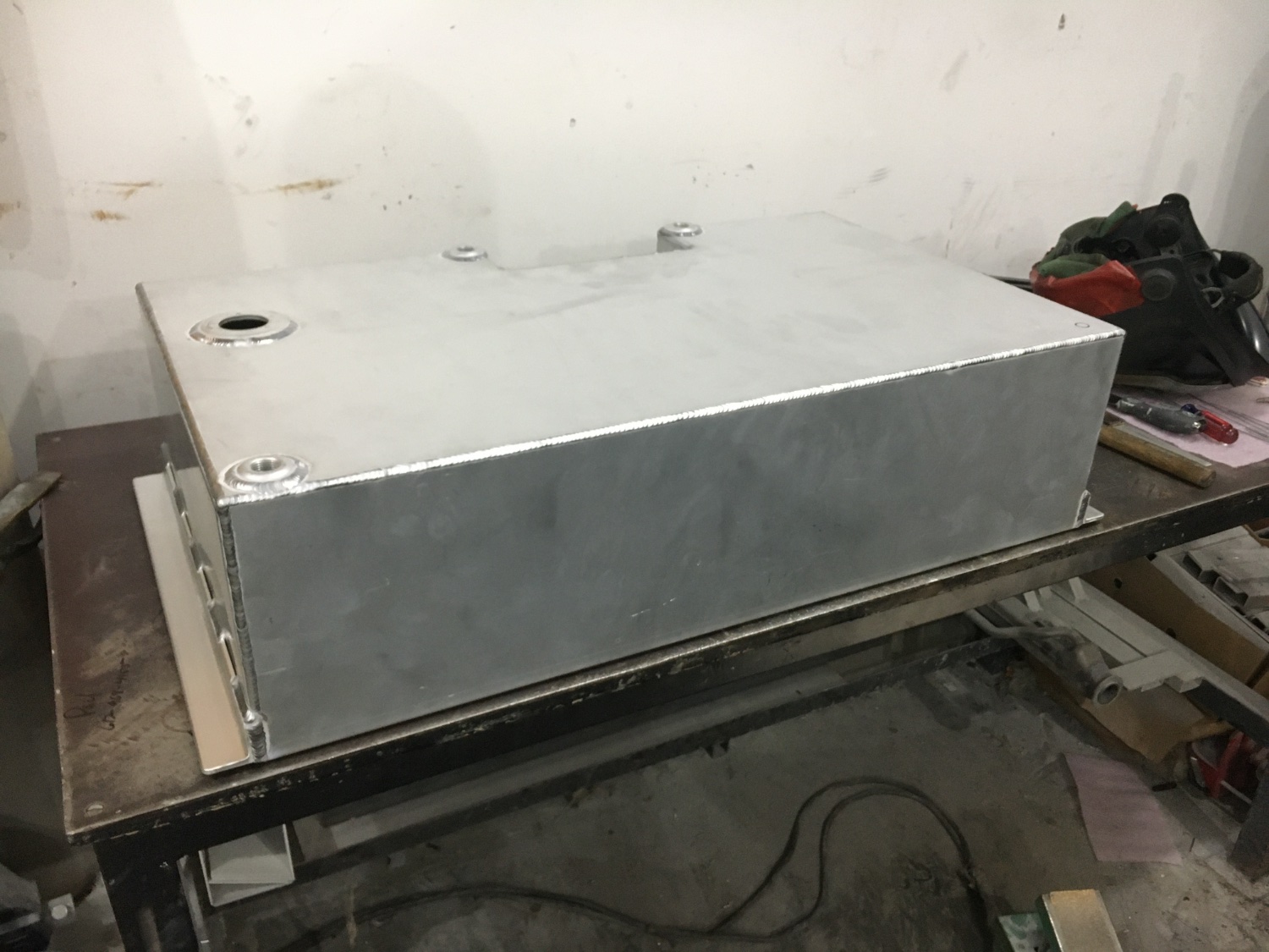

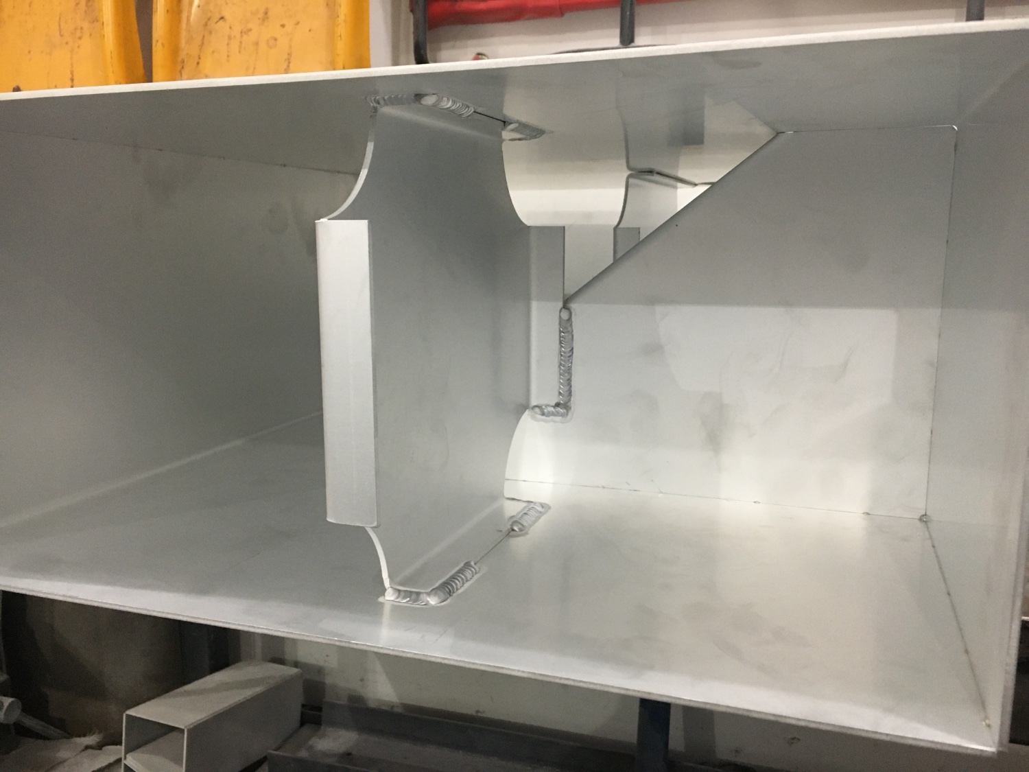

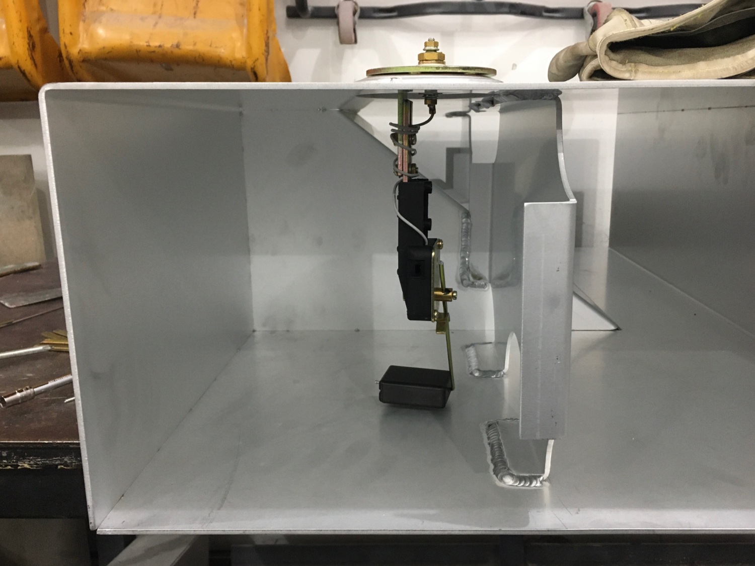

Yes, my tank completely covers my bilge. But I really have no reason to get in there on a day to day basis. I run the plug on the outside of the hull. My tank will take a bit more than 5min to pull, but less than an hour if I need to service the bulge pump for some reason. The tank also sits up an inch off the floor so any water flows right under it into the bilge. Mine is also completely one off that I built myself, it holds about 23 gallons. I'll add some pictures of my tank.
